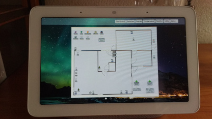

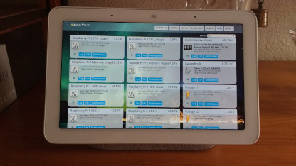

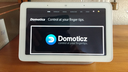

As already discussed at viewtopic.php?f=67&t=30312, I would like to share the way Domoticz can be displayed on the Google Nest Hub (formerly Google Home Hub).
It is not documented, but the Google Nest Hub display is able to present, beside other things, also webpages and so you can display your Domoticz webpage on the Google Nest Hub. It is valid for external and internal webpages, both http and https.
You need CATT (Cast All The Things)
Go to: https://github.com/skorokithakis/catt
and install catt with pip3 install cat.
It runs only on Python 3 and not on Python 2.
It is installed in ~/.local/bin.
Run it with: catt cast_site https://www.domoticz.com
or you local address of the Domoticz interface.
See:
Your touch screen works without any problem.

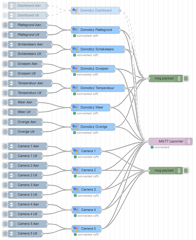

DewGew said the following:
I think catt is a very nice and simple solution to cast movies, pictures and, in our case, web pages to the Google Nest Hub.
It is simple to install (pip3 install cat) and you can run a web page with "catt cast_site https://www.website.com".
To cast these things to the Google Nest Hub is beyond Googles intentions, but works nice.
The disadvantage is that you have to send a command from the command line. That means that you have to open on another device a shell and type the command. This is not, what we want. Actually we want, that we say: "Hey (or OK) Google, Domoticz Dashboard on" and that then the Domoticz Dashboard page is shown. DewGew also suggested that your security camera's can be shown. But, if you can access your stream by your browser, you can cast your stream from the security camera to your Google Nest Hub.
My first idea was to create a virtual switch, which would activate a script and that would issue the cast command. At the same time, it would have been possible to activate that switch with a remote command from MQTT.
It did not work, because of the rights Domoticz scripts use. See: https://www.domoticz.com/forum/viewtopi ... 07#p231907
My Domoticz and catt run on a Raspberry Pi and the MQTT server and Node Red run on a different Pi. The challenge is to get a command from the second RPi, from Node Red (running NORA) to the first RPi, which has catt installed.
I found an excellent piece of software, which does exactly what I need and even more. It is a nice companion for Domoticz, Node Red and MQTT.
The program is called mqtt-launcher. It is created by J P Mens and it is available on github: https://github.com/jpmens/mqtt-launcher.
Install it on the same hardware as catt has been installed.
As catt installs in the directory ~/.local/bin, I decided to install it in ~/.local/mqtt-launcher.
Install it with: cd .local and git clone https://github.com/jpmens/mqtt-launcher.
As the display of the Google Nest Hub is only 7", the web page of Domoticz is not very big and it is not easy to tab the different pages.
(Or my fingers are too big
) I decided to make a voice command for each of the different pages. As I use the "Floorplans" on my "Dashboard", I have created 6 pages:
- Floorplans
- LightSwitches
- Scenes
- Temperature
- Weather
- Utility
- Dashboard (is optional as it is identical to Floorplans, but disabled in my flow)
As I own also 5 Camera's, with can be accessed by http://<IP Adress>/video.cgi, I have included these as well.

Please find below the Node Red flow to activate the casting of the various web pages and security camera's.
I have tested both Nora Switch node and the Nora Scene node.
As I wanted a test possibility. I decided to use the Nora Switch node, in order to start the casting and to terminate the casting of the various web pages.
As I use the "Floorplans" on my Dashboard, I currently do not use the "Dashboard". As you can see, it is present in the flow, but disabled.
All "Inject" nodes at the left are optional and used only for testing the casting of the various web pages and camera streams to the Google Nest Hub.

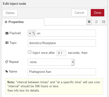

Please find below an example of the configuration of the "Inject" node for Floorplan (Plattegrond) On.
Select for "Payload" a string and insert the value, you have used in your mqtt-launcher configuration. In my case: "on".
The "Topic" should match the topic, as configured in the mqtt-launcher configuration(domoticz/floorplans)
The "Name" is up to the user.
The configuration for Floorplan (Plattegrond) Off is similar.
Will be continued in the next post.

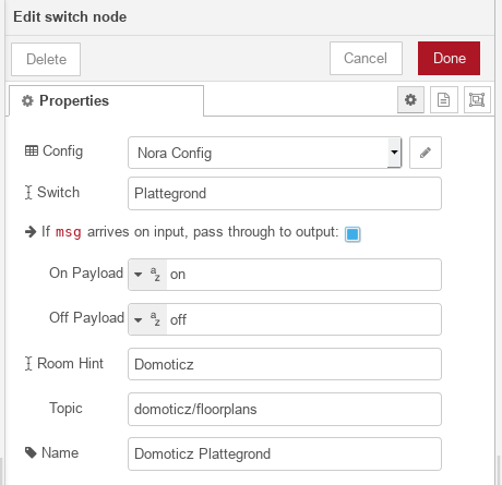

The next node to configure is the Nora Switch node.
The "Config" is a "one time event" and described in: https://flows.nodered.org/node/node-red-contrib-nora, but probably already configured.
The "Switch" is important and in fact it determines, how you call up the web page.
The "On Payload" and "Off Payload" should match the payloads, as configured in the mqtt-launcher configuration. In my case 'on" and "off".
The "Room Hint" is a little bit tricky, as the word "Hint" assumes, it is just text. However this Room Hint is used to group all devices in a single room.
You might want to use the room, where your Google Nest Hub is situated, e.g. Living Room. In this case, if you call "Hey" or "OK Google, Switch on all lights in the Living Room" it will, besides your lights, also cast all web pages of Domoticz to your Google Nest Hub. (Remember, we configured "Switches").
So I selected a non-existing room, "Domoticz".
The "Topic" is here mandatory and should match the topic, as configured in the mqtt-launcher configuration.
The "Name" of the node is up to the user.
In order to be able to inject a test payload (on or off), by means of the inject node, tick the box after "If msg arrives on input, pass through to output".
The next and last node is a MQTT output node to MQTT Launcher.
The "Server" is the name of your MQTT server and probably already configured.
The "Topic" should be empty, because the "Topic" has already been configured in the previous Nora Switch node.
In this way you can talk to your Google Nest Hub and the different web pages are shown. The same with the stream of your camera's.
I'm open for comments, questions, suggestions and all other idea's.
