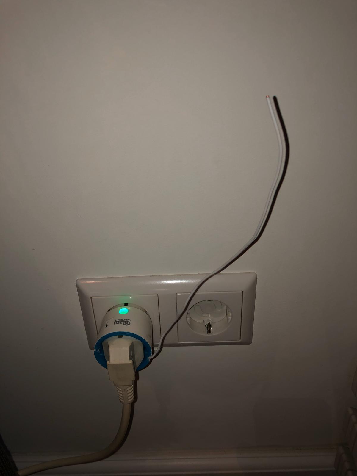

My NCC powerplugs have a crap range and go dead all the time.
So I soldered a solid copper small gauge wire to the internal antenna and drilled a small hole in the side to get the wire out. See attached pic. Seems to fix the connection/range issues..
I’ll keep you posted abt the result.

This is something you really should not do, because of electrical safety. It loses almost every certification this thing probably never had

What consequences would that have? My insurance would still be applicable if the house would burn down, which is not going to happen because of this..
I mean, what safety is impaired by soldering something to the existing antenna wire?
I’m not a US resident, so perhaps other rules and regs apply regarding liability..?

Just out of curiosity you should take a voltage reading from the bare tip of your home-made "antenna" to the ground pin of that socket. Don't know about this model, but the internals of these devices are often not isolated from the mains. Not good practice, at least tape up that exposed conductor....its human safety that's the issue here, not so much electrical safety.

I just stumbled upon this topic. Carefull with the possible voltage on the antenna. Look at this topic from another forum :
https://www.letscontrolit.com/forum/vie ... lly#p40368
There are also a lot of examples of modules which have to be flashed (firmware), Always disconnect mains / 230V power. This is non applicable to your NEO coolcam plug however.
Most of these appliances fed by 230v (from a wallsocket) aren't galvannicaly seperated (cheap / small electronics in a tiny housing).
So a DANGEROUS voltage could occur between ground and your antenna (kids, animals, wife.....will be electrocuted when touched)!

I fully agree with the safety concerns uttered above, but there's another reason why you should not do this and that is because the length of the antenna must be very precisely matched with the frequency used for the communication with this device, 848.42 MHz in Europe.
Reception problems are more easily solved by placing another -mains powered- zwave device in between of the controller and this device. Such a device will relay all data back and forth between the other devices, as the z-wave network is a mesh network.
