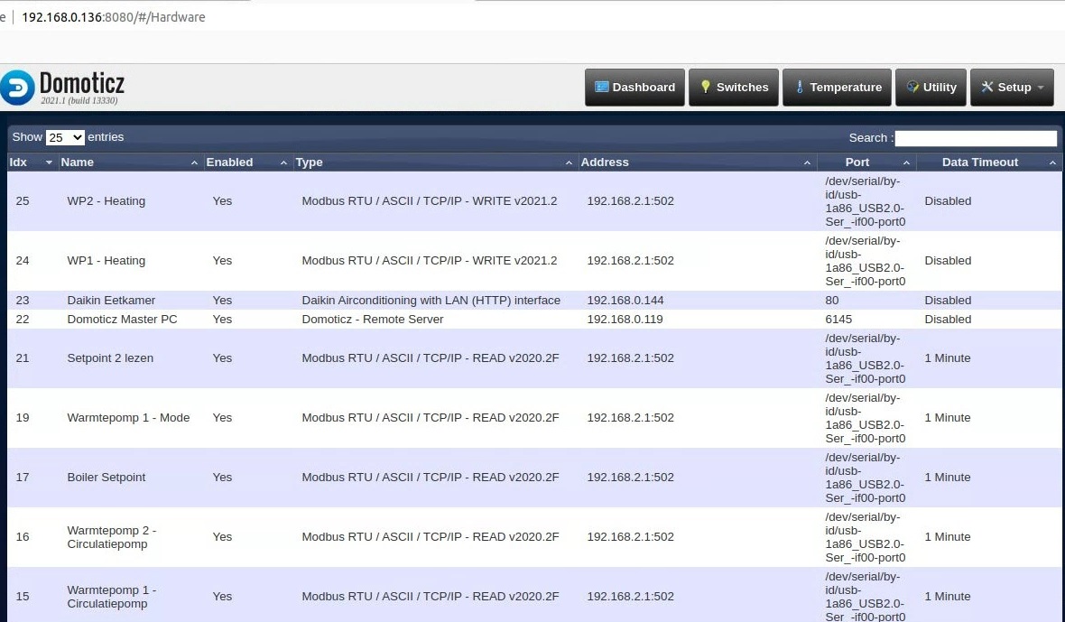

I am running the ModbusRead and ModbusWrite plugins, but am having a problem with connection errors. The errors arise from the plugin sending a request to the Modbus device from different hardware devices. I have to create a new hardware device for every modbus address and I currently have 21 of them. in the plugin you can set the pollrate and I set them differently for each device, however, after a while, some will send a request to the same modbus device at the same time and it causes communication errors because the modbus device can't handle the multiple requests at the same time. The way to keep these errors to a minimum would be to have a script running that will automatically restart the plugin if a log message with the text "Modbus error decoding or received no data". I'm not very familiar with dzvents, so how would I go about modifying the above script?
I currently restart Domoticz twice a day via a crontab, but that's still not sufficient. More effective would be to restart the hardware device that's throwing the errors as that resets its polling time and gets it out of sync with another device.
