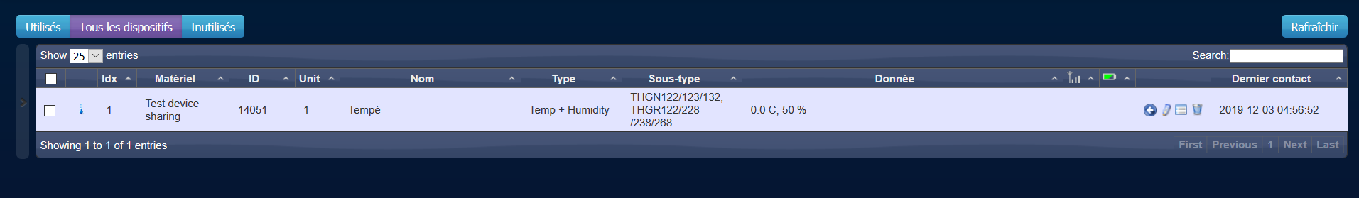

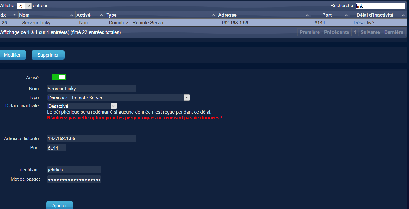

This is the log on master side.
I have tested two configuration on slave side :
1) with a real sensor (a Xiaomi Temperature+Humidity Bluetooth sensor) installed as described on
https://franken3d.blog4ever.com/integre ... r-domoticz
which is the French translation of
https://github.com/pFenners/mijia-sensor-domoticz
2) with no hardware (to be sure that the bug doesn't come from python code), the sensor is purely virtual.
In both two configuration the messages in the log are the same.

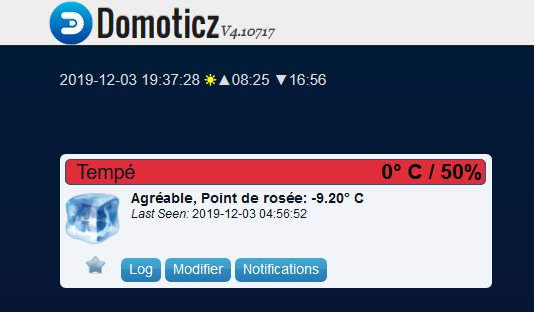

Attached are some screen shots:

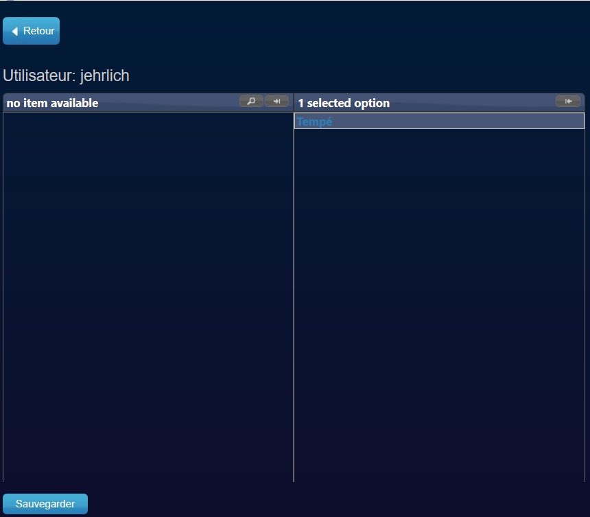

Screen copy (continuation)

Additional information
Both two Raspberry Pi have the same version of Domoticz installed (the most recent)
I have read on an old post that it could be an issue of size of a buffer. But which buffer? How to resize it ?

duodiscu92
- Posts: 28
- Joined: Sunday 11 February 2018 18:20
- Domoticz version: 4.10717
- Location: Montrouge, France
Re: Device Sharing

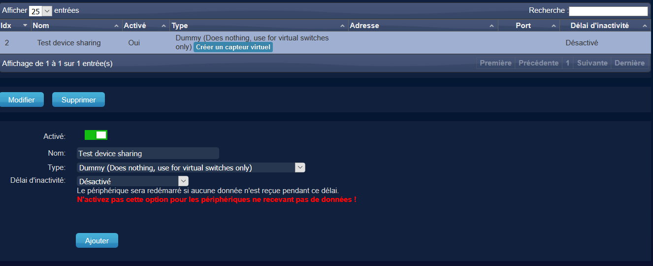

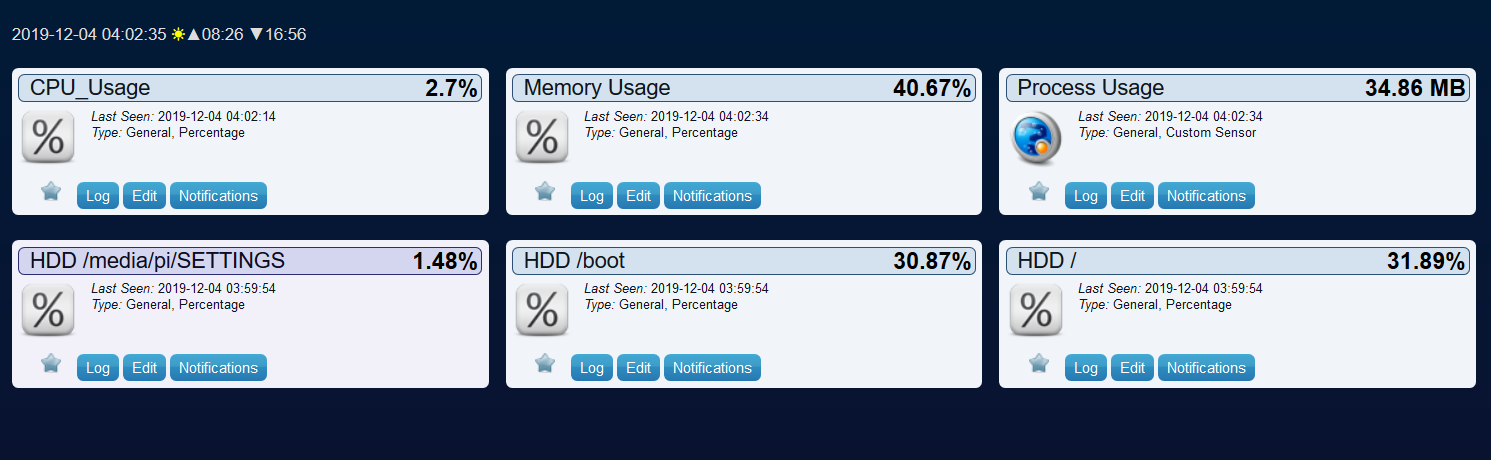

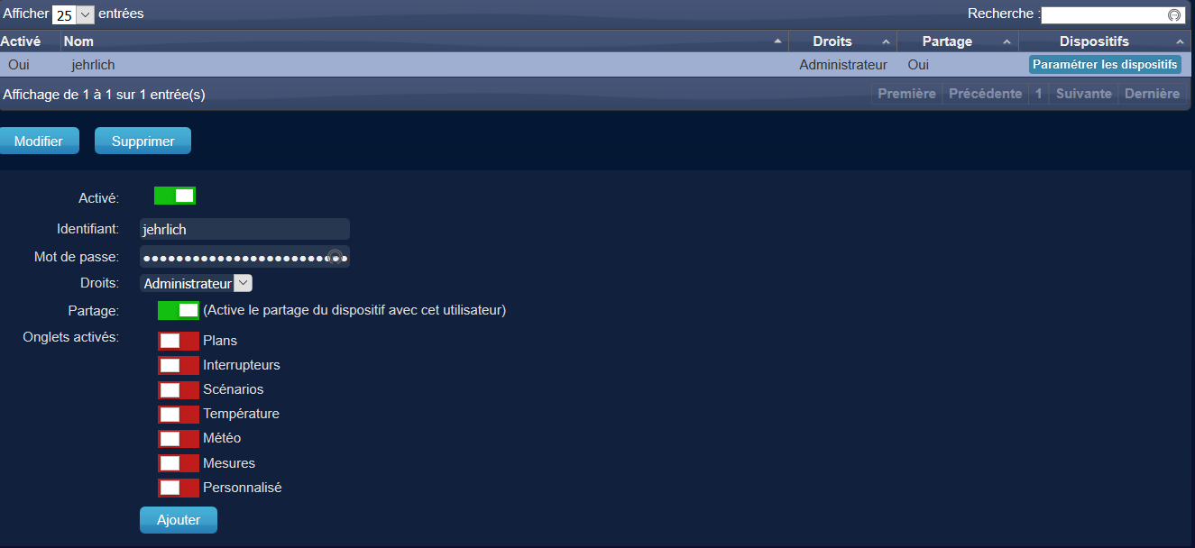

As shown below I have done the check you suggest and removed-replaced the hardware on slave side as suggested.
But I have the same error messages in the log of the master
See details below2019-12-04 04:15:20.870 Status: Domoticz Remote: connected to: 192.168.1.66:6144
2019-12-04 04:15:20.876 Error: UNHANDLED PACKET TYPE: FS20 68
2019-12-04 04:15:50.882 Status: Domoticz Remote: connected to: 192.168.1.66:6144
2019-12-04 04:15:50.886 Error: Domoticz Remote: input buffer out of sync, going to restart!....
I confirmIn your profile, you indicate that you are running the latest version. I assume the latest stable version 4.10717
YES1. In the slave you have set a password for the website protection.
YES2. Remote shared port 6144
YESIn "Setup" => "More options" => "Edit Users" you have set a user etc ...
YES4. In the Master you have specified in "Settings" => "Hardware" the correct etc ...
DONE, see screen copyI suggest that you remove all hardware from your slave and install only "Motherboard Sensors" in your slave.
What do you mean ? as on this screen copy ?Do not forget the enable "New Hardware" in your Master.

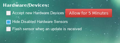

1. What I mean with:
In "Setup" => "Settings", you have the following option:
Click the checkbox, marked "Accept new Hardware Devices" or click "Allow for 5 Minutes".
And don't forget in "Setup" => "Devices" to click the green arrow for your devices, so that it turns to blue
Otherwise you will not see the devices under the "Temperature" and "Utility" tab.
is the following:Do not forget to enable "New Hardware" in your Master.

In my case the "Slave" has IP address: 192.168.10.51.
So in both machines you should see, that the "Master" is connected to the "Slave".
If the "Master" is updated, you should see in the "Master" log, lines, like:
2019-12-04 13:46:36.203 (Raspberry Pi 1) General/Percentage (Raspberry Pi 1 CPU_Usage)
2019-12-04 13:48:06.399 (Raspberry Pi 1) Temp (Raspberry Pi 1 Int. Temperature)
2019-12-04 13:48:06.416 (Raspberry Pi 1) General/Percentage (Raspberry Pi 1 CPU_Usage)
2019-12-04 13:49:36.558 (Raspberry Pi 1) General/Percentage (Raspberry Pi 1 HDD /boot)
2019-12-04 13:49:36.581 (Raspberry Pi 1) General/Percentage (Raspberry Pi 1 HDD /)
(Raspberry Pi 1 is the name of my "Slave")
You don't see anything on your "Slave".
So obviously, as you see only the connection of your laptop and not the Incoming Domoticz connection from your Domoticz "Master", I think that the connection not has been made. Strange.
Is there anything in your "Slave" that may prevent, that a connection is made?

- FireWizard
- Posts: 1975
- Location: Voorthuizen (NL)
Re: Device Sharing
You wrote:
Let us look to the slave first.
In the log of the slave I see:
If there is any valid reason to do so, because you have planned to use this port for something else, you can change it. However do never change it to 6144, because this is the port that is used by Domoticz Remote server.
This will definitively cause a conflict and you will see that 3 lines later:
nano /etc/init.d/domoticz.sh
Edit this line, so that it looks like: DAEMON_ARGS="$DAEMON_ARGS -www 8080"
If you open your editor, you will see 6144 as port. Change it to 8080
Leave the editor and give the following commands:
systemctl daemon-reload
service domoticz stop
service domoticz start.
If everything is alright, you will see:
Let"s try this first.
You wrote:
That's not in my vocabulary, however I cannot force you to go on.So i think I am going to give up ...
Why did you change the web server's http to another value than 8080?2019-12-10 10:31:04.900 Status: WebServer(HTTP) started on address: :: with port 6144
And this explains also:2019-12-10 10:31:04.916 Error: Exception starting shared server: bind: Address already in use
So lets change this first and I suggest to use port 8080.2019-12-10 10:31:34.711 Error: Error parsing http request.
2019-12-10 10:32:04.735 Error: Error parsing http request.
2019-12-10 10:32:34.749 Error: Error parsing http request.
2019-12-10 10:34:46.560 Error: Error parsing http request.
2019-12-10 10:35:16.578 Error: Error parsing http request.

Done as you recommended.
See log below.
Note that
Log on slave (ip=192.168.253.100)
See log below.
Note that
appears only after upgrading to the beta versionError: Error parsing http request.

2019-12-10 22:54:51.775 Status: Domoticz Remote: connected to: 192.168.253.100:8080
2019-12-10 22:54:51.781 Status: Domoticz Remote: disconnected from: 192.168.253.100:8080
2019-12-10 22:54:51.781 Error: UNHANDLED PACKET TYPE: FS20 68
