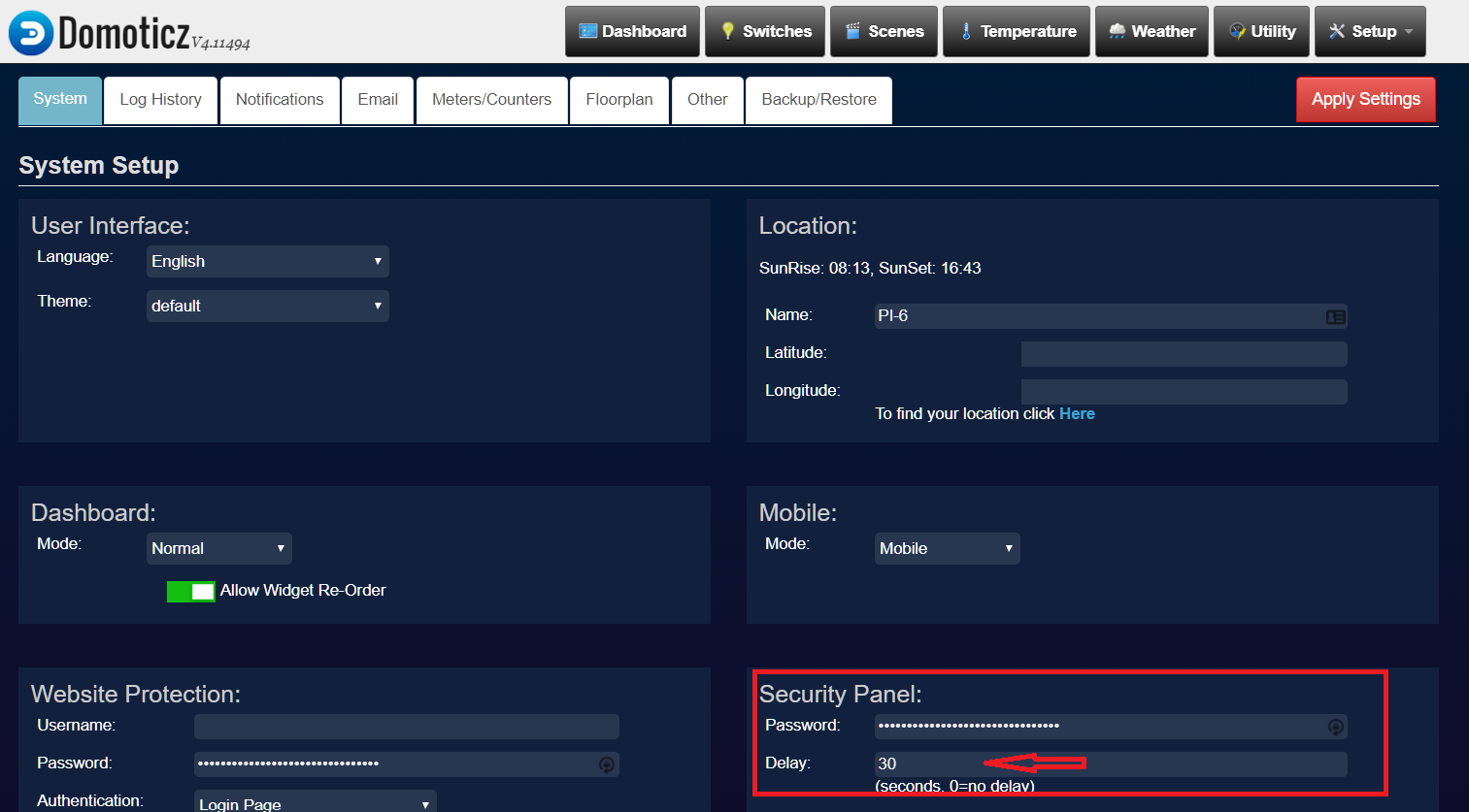

You can set this in [setup][settings][systems]

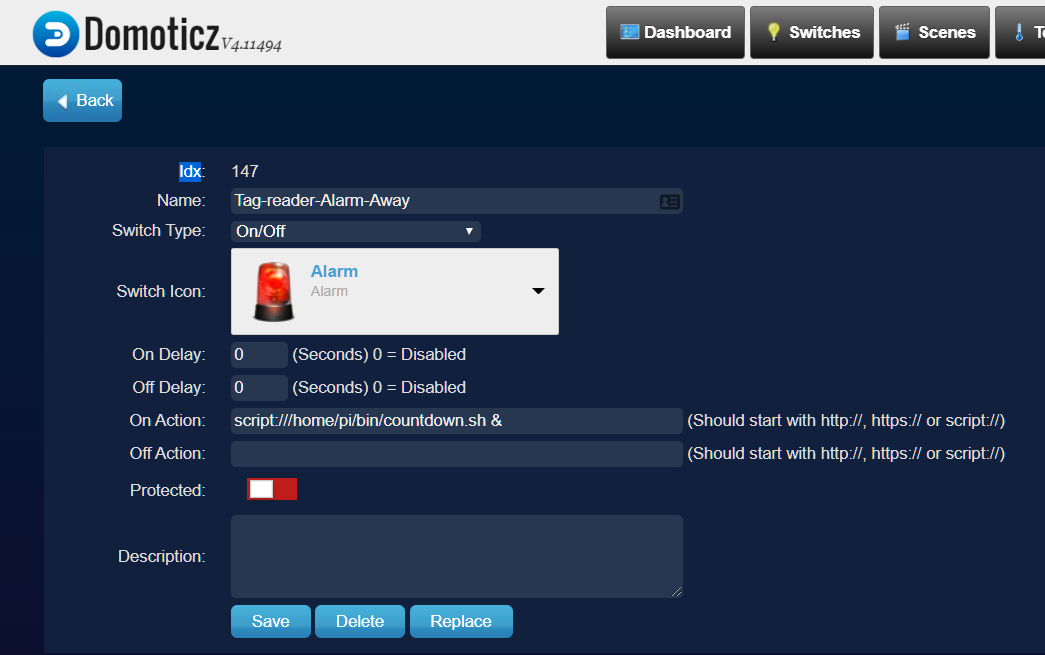

Is it possible to execute a bash command right after the tag, and before the delay counts down? Maybe with os.execute(/home/pi/bin/countdown.sh) ?
I want to sent a countdown (sound) to a speaker, direct when arm away is pushed/tagged on the tagreader.
That is possible but you also put this in the On action field

Yes, I know that. In settings, the delay is default set to 30 seconds. But this 30 seconds are not working when the security panel is triggered in the background (and not via the securitypanel page).
The problem if I set an script:// action , this script is executed after the switch went on and after the delay. I want it to be triggered, immidiatly, before the delay. Or am I wrong here in how it is working?

AllesVanZelf wrote: Friday 22 November 2019 17:53 Yes, I know that. In settings, the delay is default set to 30 seconds. But this 30 seconds are not working when the security panel is triggered in the background (and not via the securitypanel page).
It is working on my system but I am on a recent Beta so maybe that is the explanation for the different behavior.
There is no delay in the update of the tag-reader status. The delay is applied to the state Change command of the security panel itself. So the On action set on the tag-reader should start immediately.

waaren wrote: Friday 22 November 2019 18:01 It is working on my system but I am on a recent Beta so maybe that is the explanation for the different behavior.
I'm on 4.11501, and here the 30 seconds are not added to the 20 seconds I have just set in this dzevents script. Strange.
Very good. You're right.

But Tag-reader-Alarm-Away is not set like in the tag reader script. So, the "script:///home/pi/bin/countdown.sh &" is not started. That is a pitty. I really like the countdown.

Below script will handle the start of the countdown. You need to remove the On action line to prevent that the script wil be started twice.
