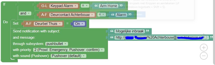

I made a blockly to activate when i set my alarm to "Arm Home".
It works perfect. But stil i have one problem with it.
When i activate the status on my keypad it strait away activates my doorbel en sends a pushbullet message. It only should do that when the doorsensor is activated and the alarm status is "Arm Home"
How can i prevent this action?
My Blockly script:
Blockly arm home.JPG (46.21 KiB) Viewed 490 times

Maybe your doorsensor does have an off-delay and it's still 'active' when you activate the status?

Hi Knielen,
thx for the reply, the doorsensor its status is always active in domoticz once it has send the status when opend.I tried to set the status by a blockly back to normal with a timedelay. But it seems not to change in domoticz.
