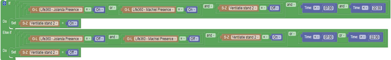

i have a blocky running which id like to change to dzvents, im a terrible coder, i tried something but this doesnt work.
Can someone help me out with translating my blocky to dzvents?
So what i want is my ventilation based on presence and time, when everybody is away/at night fan off, during the day or i 1 person at home, fan on.
thanks a lot

gielie wrote: Thursday 21 November 2019 9:45 i have a blocky running which id like to change to dzvents, im a terrible coder, i tried something but this doesnt work.
Please don't post images as a link but attach them as an img file. The link to the image was not visible when your server could not be reached.
Can you test this ?

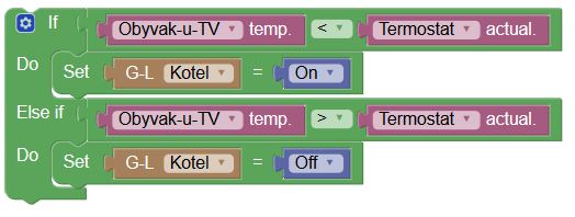

excuse my english, but i need some help converting blockly script to dzVents
This is starting the heating, where I have a timer set directly on the switch "Kotel" and starts when I change the value on "Thermostat", which I have as a set point.
Thanks for the help

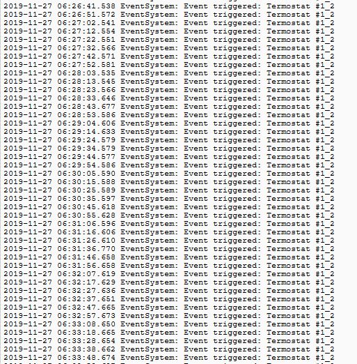

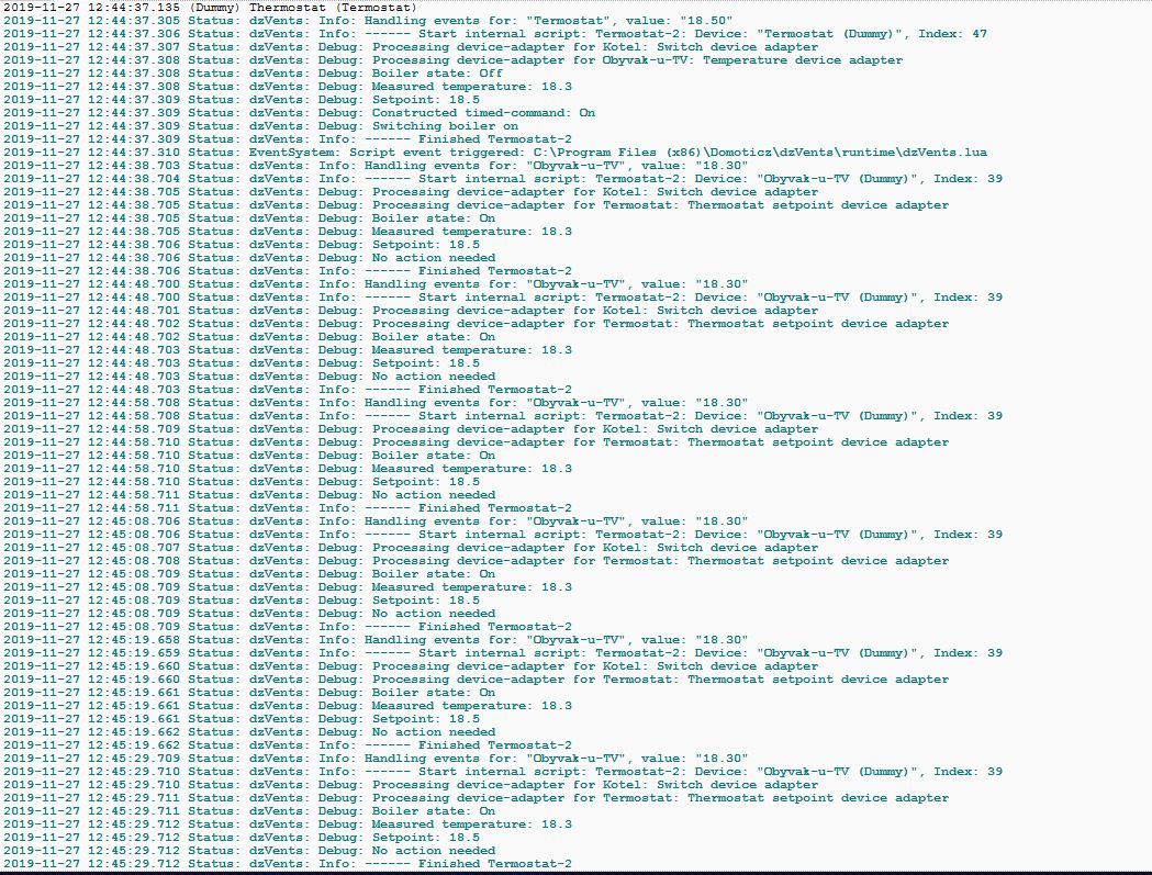

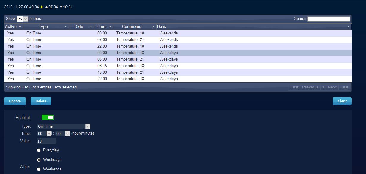

Thanks for answering, I did it according to this procedure: https://www.youtube.com/watch?v=Ga8mSQ-XCbc
Picture of my Thermostat timer setting and Log.
I would like the script to run only when the current "Thermostat" value changes
I want to convert it to dzVents because I can't find the boot value in Blockly "device.changed"

Thank you very much, the script works. Sending log. ;)
