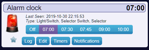

For the dzVents script below you will need a selector switch. Level 0 should be named 'Off' and other levels can be times in hh:mm format.
Selectorswitch for alarmclock times
