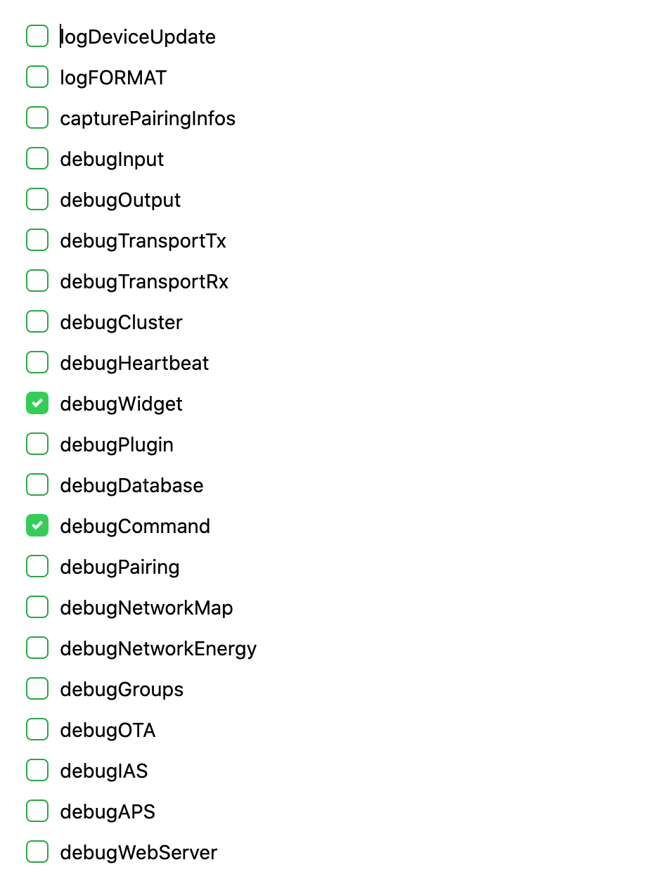

If this happens on beta only could you enable debugWidget and debugCommand ( with web admin GUI).

Then switched to beta again and it's the same result. The level changes until it's 100%. I got some logging of my test. For this test I made a dzVents script triggered by a switch an the only thing it does is the command 'setKelvin(60)'. I did it a few times and the level changes 3 times and the third time is 100%. I started with 30%.
I tested multiple times and the dim level changes randomly, but every time it takes max 4 setKelvin commands until its on 100% and then it stays 100%.
Hope you can find something in the log.

I just did some more tests with the stable and the dim level also changes. But from 30% to 19% and it stays 19%.
See the logging below

pipiche
Posts: 2034
Re: Zigate + Tradfri gu10 dual white added as RGBWW device
Post by pipiche »
Did you enable debugCommand , as I do not see any command.
If I understood your dzVent script should trigger some action.
The only think I see is the state return update .
When processing a Color action, the plugin expects 2 attributes, the Level value and the Color value.
https://www.domoticz.com/wiki/Domoticz_ ... emperature
In your case if the Brightness is not provided, I would be interested to see what dzVents/Domoticz do and send to the plugin.
So the best is:
enable debugCommand
enable debugWidget
Screenshot 2019-10-29 at 07.56.55.png (122.12 KiB) Viewed 1262 times
ronaldbro
Posts: 327
Joined: Thursday 15 November 2018 21:38
Post by ronaldbro »
Yep, both are set (and logDeviceUpdate too)
