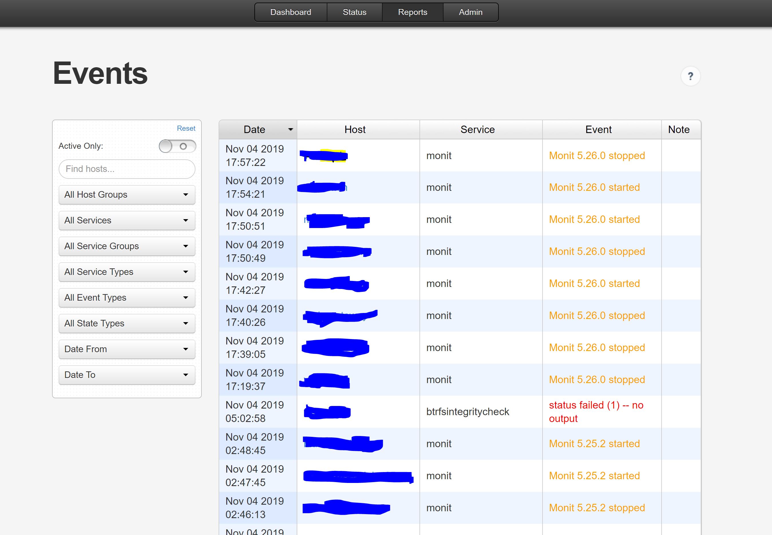

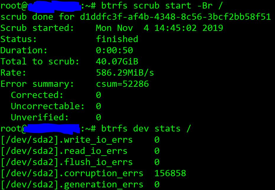

Wow! Monit / Mmonit just picked up a server with a corrupt BTRFS volume!
I investigated and sure enough, it was corrupt with unfixable errors, now restoring from a backup. 8-)
Checking the server manually (output below):

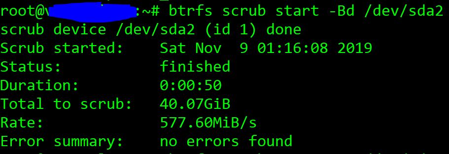

Using the below command (will probably vary a bit for different systems), I was able to get a list of files that had become corrupt on the BTRFS file system, delete them (which fixed the file system corruption), then restore just those files that had become corrupted from a backup.
journalctl --output cat | grep 'BTRFS' | grep '(path:' | sed -n -e 's/^.*\(path:\)/\1/p' | cut -f2- -d: | tr -d ")"
Note that I ran this command before the one above: btrfs scrub start -Bd /dev/sda2
Upon deleting the list of corrupt files....
