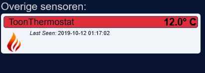

I prefer using the scripts that is made in dzVents because it works fine except the temp thingy on domoticz.
Someone that is "good" in scripting with LUA/dzVents maybe knows a solution. When i click the switch to Away this URL is called:
http://192.168.1.x/happ_thermstat?actio ... ureState=3
Toon will switch to scene Away and temp will be set to 12c (as example)
But Domoticz does not know that Toon is now set on 12c.
So i want to know is it possible to change this "number"
To something else without starting this:
      devices = {
         'ToonThermostat'
             print(device.setPoint*100)
             domoticz.openURL(string.format('http://%s/happ_thermstat?action=setSetpoint&Setpoint=%s', domoticz.variables('UV_ToonIP').value, device.setPoint*100))
If this is started: domoticz.openURL(string.format('http://%s/happ_thermstat?action=setSetpoint&Setpoint=%s', domoticz.variables('UV_ToonIP').value, device.setPoint*100))
The number on the dashboard (domoticz) will change to the correct one but also Toon receives a command and the scene will be switched to manual.
So im looking for something that can change the temp on the dashboard without sending info to Toon. Maybe something like:
 -- Update the thermostat sensor to current setpoint
        if domoticz.devices(ToonThermostat).setPoint*100 ~= currentSetpoint*100 then
             domoticz.log('Updating thermostat sensor to new set point: ' ..currentSetpoint)
             -- Silent change temp only on domoticz dashboard
                commandArray['UpdateDevice'] = otherdevices_idx[ToonThermostat]..'|1|'..currentSetpoint <- something like this??
        --     domoticz.devices(ToonThermostat).updateSetPoint(currentSetpoint).silent() Dont use this. will send command to Toon.
