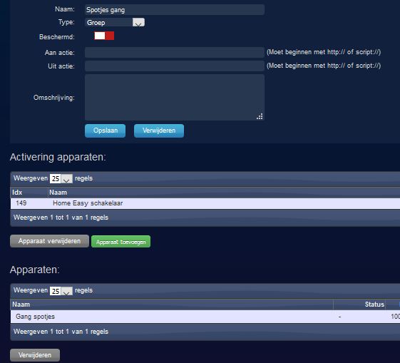

I think you should use a group scene.
With the 433Mhz switch you can switch a Z-Wave device on or off.
In this example i can switch the "Gang spotjes" on or off using the 433Mhz "Home Easy schakelaar":
