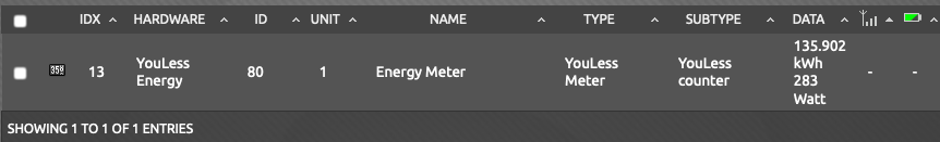

I used to have a youless unit measuring the electricity usage on an old meter. The power company upgraded my meters and now youless can get the data from a P1 connection (current power usage, combined meter reading, meter high-rate reading, meter low-rate reading, gas).
I have the youless on the same address and i'm only getting the current power usage. How do I get the other readings into Domoticz?
Output of http://youless/e
[{"tm":1569145884,"net": 141.646,"pwr": 535,"ts0":1569099894,"cs0": 0.000,"ps0": 0,"p1": 62.455,"p2": 79.191,"n1": 0.000,"n2": 0.000,"gas": 9.169,"gts":1909221150}]
What am I missing?
