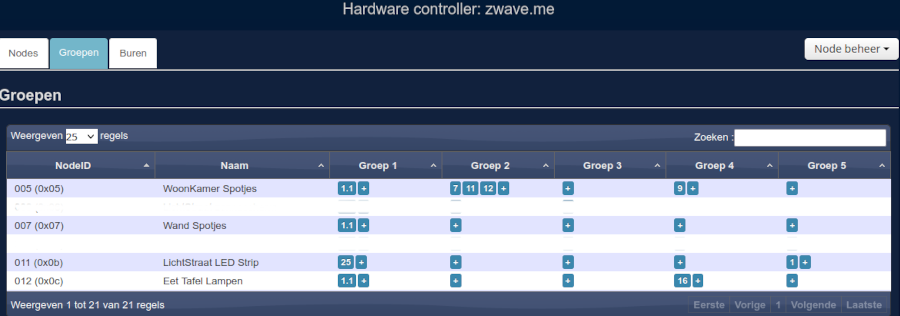

cos4x4
- Posts: 7
- Joined: Monday 01 February 2016 21:38
- Domoticz version: 2020.2
- Location: nieuwegein
Re: installing Fibaro Dimmer-2
i don't think it will work, maybe better connect them together (associate)
swicth nr 005 will turn on/off S1 of 005 and Group 2 007,011 end 012
Group 4 turns S2 on/off and 009
