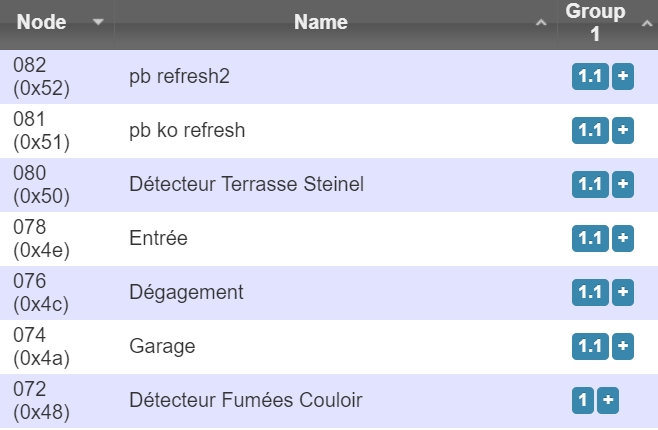

I have several nodes with 1.1 in the Group 1.
When I remove 1.1 to put 1, the node is back in 1. Could it be a cause of issues?
For one device, I have no refresh in domoticz when I use the switch (the real one!). Could it be due to this?
Version: 4.11307
Build Hash: 7439b1b9e
OpenZWave USB
Version: 1.6-808-gbb0a4bf7-dirty
Version: 4.11307
OpenZWave USB

no answer?
Am I the only one with Group 1 with 1.1 instead of 1 ?
Still the same after upgrade to
Version: 4.11337
Build Hash: c3a517bff
Compile Date: 2019-09-23 15:39:16
on a new device just added with the version.
BTW, the refresh on this device doesn't work
no answer?
Version: 4.11337

hi mate, i also have the same 1.1 but i don't have issues with it

i think the change to 1.1 happened when going from zwave 1.4 to zwave 1.6
1 represents single instance devices and 1.1 devices which are capable of communicating multi instance
so i think 1.1 is actually good since it proofs the device is capable of communicating with the new zwave 1.6 protocol
i have some devices which create problems when they are using multi instance. those devices are set to use single instance to function ok
the fgms-001 is such a device
also qubino devices are not 100% multi instance capable
maybe the explanation is not 100% correct.
you should however not be able to change the 1.1 to 1
if you delete 1.1 and add either 1 or 1.1 it should stick to 1.1

thanks for you explanation
So perhaps it is not an problem to have this 1.1, but I have another Qubino with this 1.1 and no refresh neither.
FIBARO System FGD212 Dimmer 2+ OK
Qubino (Goap) ZMNHBDx Flush 2 Relays+ OK
Qubino (Goap) ZMNHADx Flush 1 Relay+ KO
Qubino (Goap) ZMNHDD1 Flush Dimmer+ KO
OK : refresh OK
KO : no refresh
OK : refresh OK
KO : no refresh

Re: Z-wave Group 1.1 instead of 1
New test
on another Qubino (Goap) ZMNHDD1 Flush Dimmer+
when the device is still "Not Used" the refresh is ok
when the device is "Used" the refresh doesn't works
So I think it is not an issue in openzwave, but more in Domoticz

Could not get this result again today. Perhaps it was too later yesterdayhestia wrote: Saturday 05 October 2019 23:59 New test
But the state of my device is still not refreshed in Domoticz

I've got info from Qubino support
<<Here's the data we send to the Domoticz developer about the Flush Dimmer for the beta version 4.11213 of the gateway. We send this data + extra notes for all of our devices.
The gateway configures a multi channel lifeline association, using MULTI_CHANNEL_ASSOCIATION_SET(groupId=1, multichannelnodeId=1, endpoint=1). The gateway should have configured an ordinary lifeline association, using ASSOCIATION_SET(groupId=1, nodeId=1).>>
So on their side, they consider that 1.1 is not the right value!

I have the same problem, no refreshes from two Qubino flush shutter controllers, which have a lifline group "1.1". I also have a third flush shutter, installed before the update to the newest beta of Domoticz and is still in group "1". This device does refresh when chaning position of the shutter.
The new two do not update.
Resolved in this topic https://www.domoticz.com/forum/viewtopi ... 15#p225812
