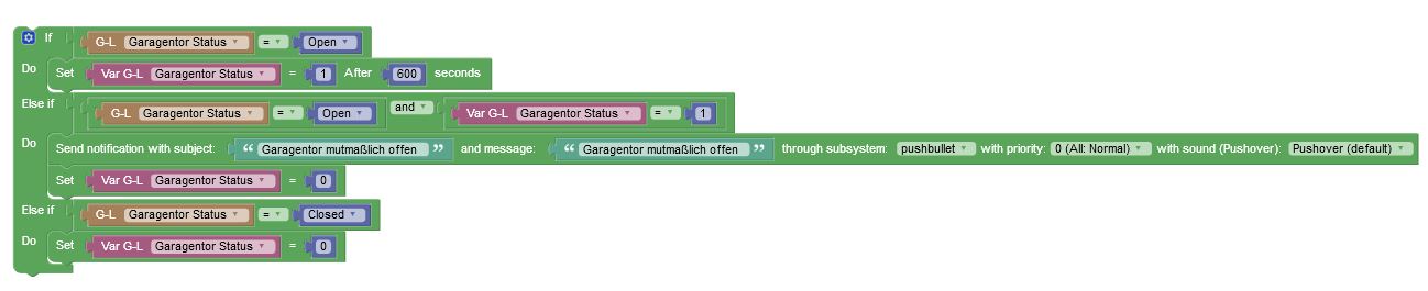

I have got several versions of the program with the common ground that they do not work. In the try listed below I'am using a user variable that is set to "1" after 600 seconds.
The notification is sent, when the door status is changing from open to close. There is also a problem with the trigger, the 2. Else-if-part is not executed. In result, the user variable stays in status "1".

Re: "If the door is open for more than ten minutes --> Send message. Advice needed
It will never reach the second condition as the first one is valid when the status changes to Open.
I am always using LUA scripts for logic like this, or you could use dzEvent as well as that is also easy to test for the time the switch changed last.

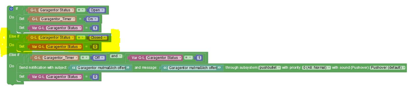

In the meantime - thank you jvdz - I developed the blockly script and extended it by a dummy switch as a timer: It seems to work, but there is one problem, that I do not understand:
The yellow marked middle part of the script is ignored by domoticz and I don't know why.
thank you for the advice and the code snippet. Tomorrow I will try to understand how it works - sounds interesting.
- Unbenannt.JPG (56.09 KiB) Viewed 4718 times

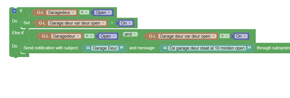

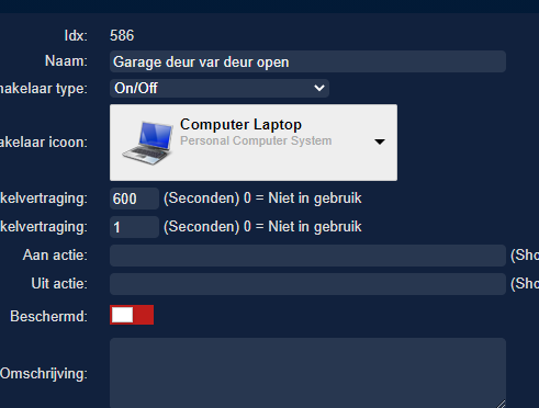

I have done it this way, works o.k.
- gd2.png (16.16 KiB) Viewed 3508 times
- gd1.png (22.85 KiB) Viewed 3508 times
I... I don't understand how that work, but it does !
Well done. And thanks.
