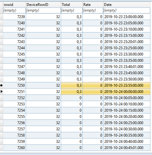

Maybe this can help you, on 23:59 hour the last update is written to the graph, on 00:00 hour the value of the day total resets to 0mm. After 1 minute the total previous day total becomes negative and will be displayed as a positive value in the day graph. (Donderdag) see database.

Meanwhile, I have found 2 problems in Domoticz with this rain counter. These problems are NOT related to python plugins, but can also be seen in other hardware like Buienradar!!!
1. You will see that almost every day, the first hour has no data (also no 0 mm). As you can see in your table of data, that Domoticz (so not the plugin) stores the data every 5 minutes (sometimes 1 second later). At the beginning of a new day Domoticz resets its own internal counter to 0. If the PWS sends in the first hour its total precipitation, this value is stored at dd-mm-yyyy 01:00:00, not at dd-mm-yyyy 00:59:59. The graph should not show 00:00, or store the total rain fall at hh:59:59.
2. Sometimes the 00:00 shows the value 0, but then you will see a negative value at 01:00. For the day total this is used as positive value for the new day. See image as an example.
Aantekening 2019-11-06 201145.jpg (60.92 KiB) Viewed 18399 times
I can not fix this. Hopefully the Domoticz programmers can do some more investigation.
