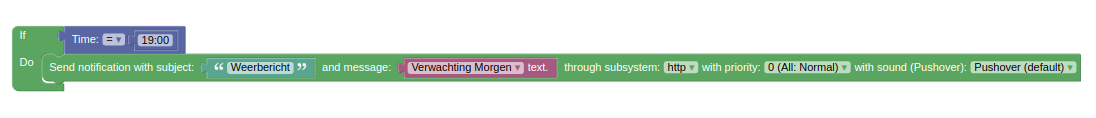

I have a possible issue with a blockly that I created to send a notification to Telegram.
Instead of providing the text in the notification, it sends an 'utilitydevice[24] to Telegram..
Screenshot from 2019-08-18 21-07-46.png (19.1 KiB) Viewed 1125 times
What is it that I'm doing wrong ?

I guess because you are using the wrong block for the text message, use the same as you use for the subject.

You also send to http and not to telegram.
