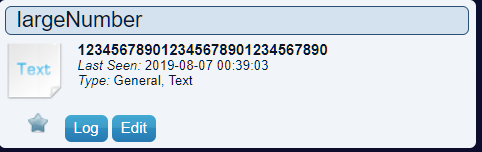

sander88 wrote: Tuesday 06 August 2019 23:13 I would like to store a time value (in seconds) for virtual sensor.
Would it be an option to store it in a text sensor ?
http://IP:PORT/json.htm?type=command&param=udevice&idx=2268&nvalue=0&svalue=123456789012345678901234567890
Thanks. Yes, I used a text sensor in this case.
