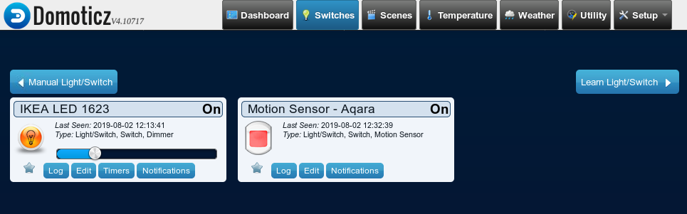

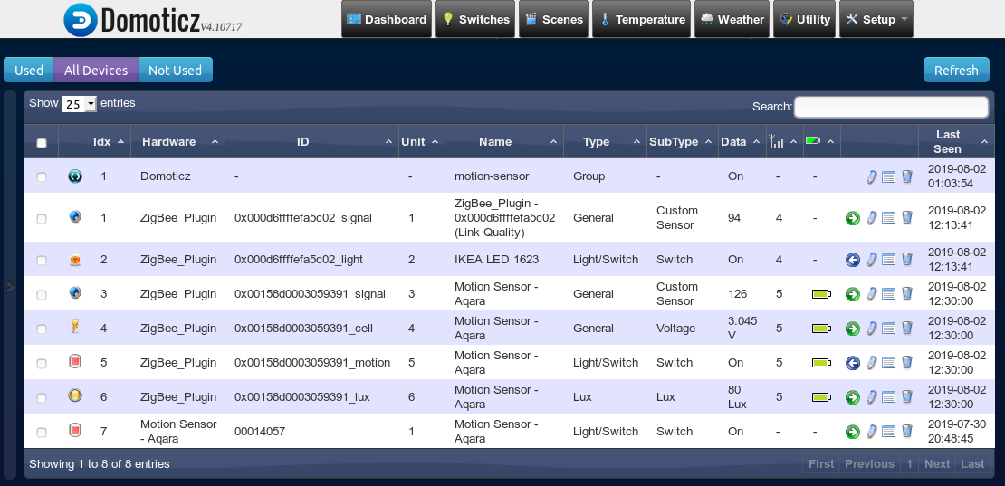

I have thought this is going to be straight forward and easy. I buy the basic stuff to get started. 12 – 24h try&error later I still haven't figured it out.
My devices:
  • IKEA LED1623G12 (just a white bulb, with dimmer)
  • Xiaomi Aqara motion sensor RTCGQ11LM
  • Texas Instruments CC2531 USB Stick
I have installed Domoticz according to the Wiki on a RPi2, with Zigbee2MQTT-Plugin. I finally managed to pair all devices and I can control the bulb in the Switches Menu.
I would like to set it up this way:
If the motion sensor triggers, it will send a signal to CC2531 (Zigbee) and Domoticz will switch the bulb on. Totally simple not even thinking about day or evening.
After searching YouTube, the Domoticz Wiki, reading many tutorials and finally search in the forum I cannot find a simple "getting started". I may write one in the Wiki once I found out and allowed to do so.
Can you please give me an idea how I simply connect these without Blocky or LUA (if it is possible) ?
Attached 2 pictures of my install.
screenshot of my devices
Domo devices 2019-08-02.png (115.12 KiB) Viewed 2349 times
screenshot of my switches
Domo switches 2019-08-02.png (45.92 KiB) Viewed 2349 times

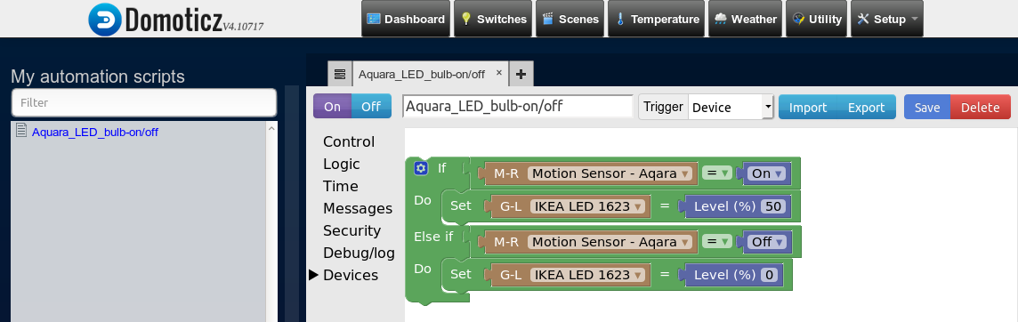

You say you don't want to use blockly out scripting. Are you up for a challenge?
I'd just pop those few blockly pieces together and be done with it
If pir is on, than bulb level is 100
Elseif pir is off, than bulb level is 0
Tido
Joined: Thursday 01 August 2019 21:50
Domoticz version: V4.10717
Re: Aqara motion sensor, IKEA Tradfri bulb, CC2531 – how to setup?
Post by Tido »
jake wrote: Friday 02 August 2019 23:33 Are you up for a challenge?
of course I am ;) Thank you for your 'code' I missed to read in the Wiki about Blockly first, so it took me a bit longer to figure out the Elseif. Very nice tool:
Important fact, both (Aqara & LED) must be listed in "Switches".
Domo Blockly 2019-08-03.png (67.69 KiB) Viewed 2320 times
However, about my original request... it is not possible without doing 'coding' or in other words, it is done in Blockly or Code itself?
