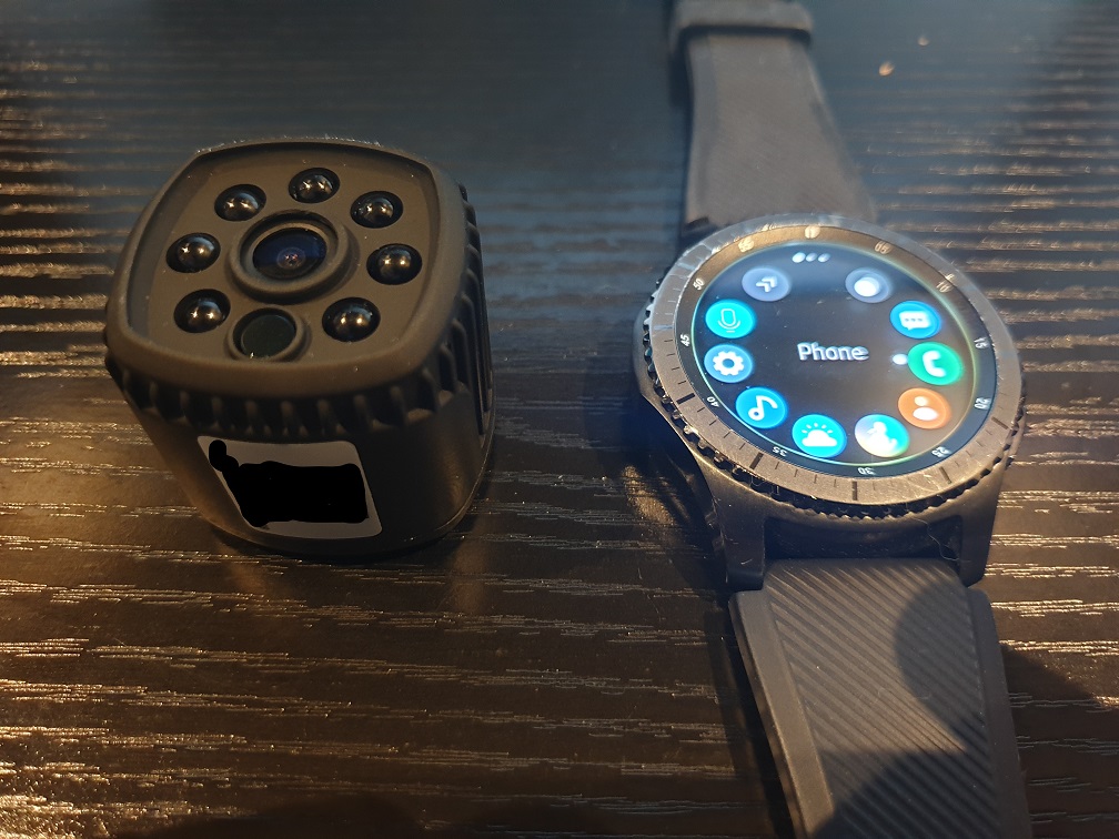

The M709 next to my Gear S3 Smart Watch for size comparison.
This is a very impressive camera that delivers a full 1080p resolution with night vision in an extremely small form factor.

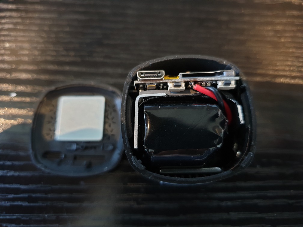

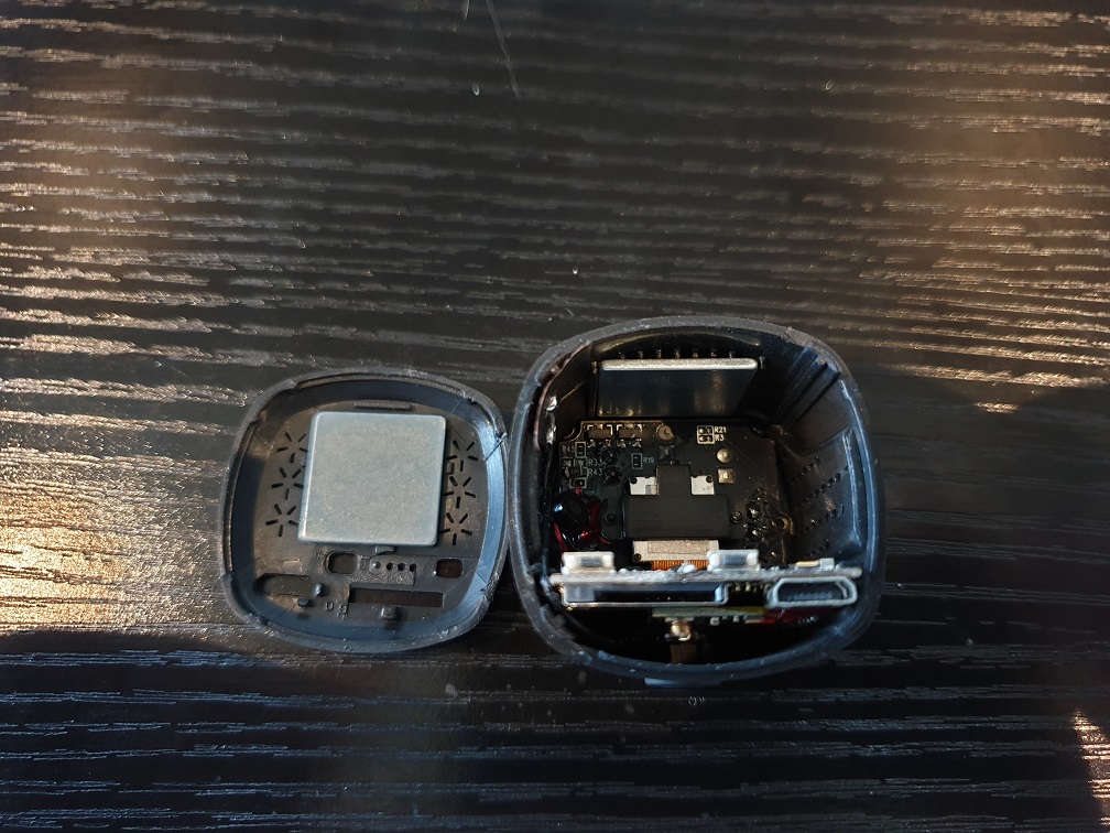

Ended up doing a few hardware mods:
1) Remove LEDs
2) Modify switch so the camera starts automatically on power restore
3) Remove Lithium Ion battery
Can confirm that the camera works just fine with the battery removed.
As you can see most of the space inside the case is used for the battery. It's surprising how light weight the camera is without the battery.

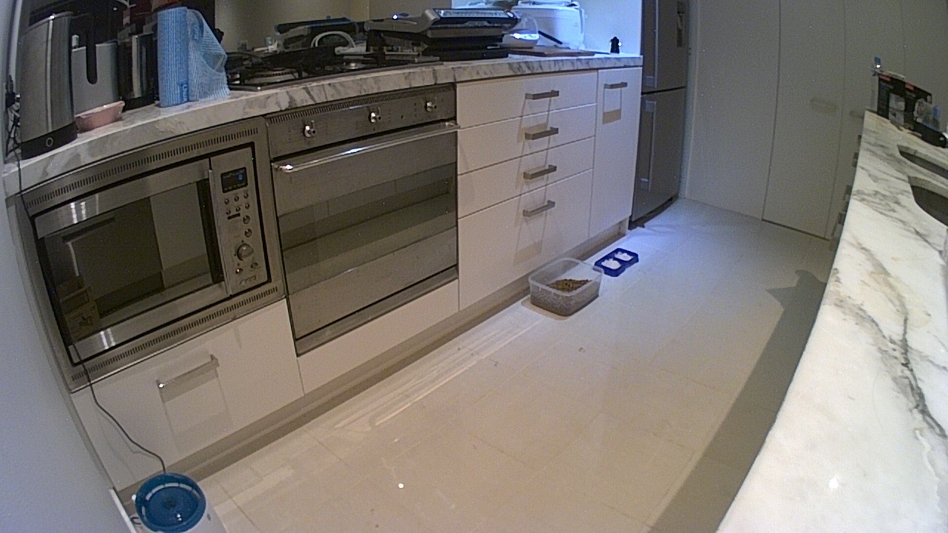

I setup an M709 in the kitchen to monitor the cats, I am impressed with the image quality for such a small camera.
Note my highly professional mounting on the side of the USB power adapter. 8-)

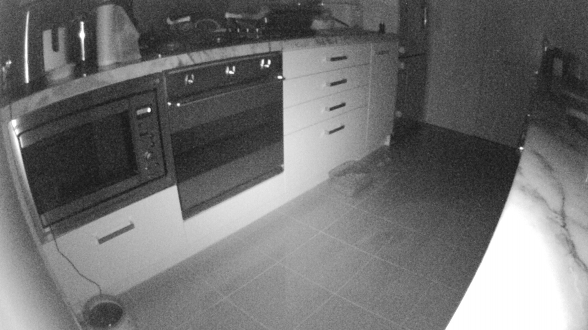

Photo at night with lights on:
Photo at night with lights off (Camera is using its IR LED's), picture is very grainy.
