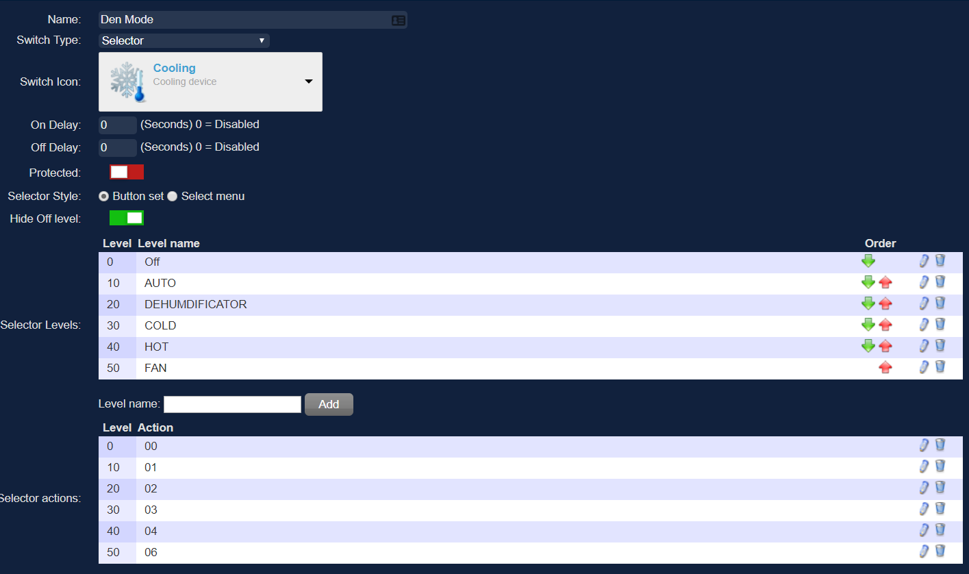

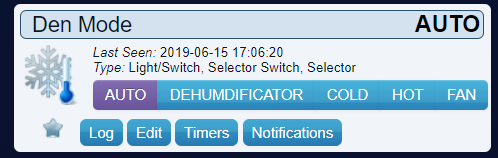

I've got my Dailin Wifi up and running and can control it just fine with the buttons on the Widgets from the Domoticz Tabs. :)

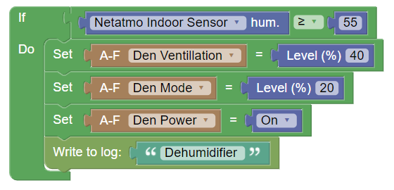

Works really well.... but I'm not sure I've got the right parts for the Blocky "Set" command to change the "Mode" to say "20%" (which I think matches to Dehumidify = Mode 2 on the Daikin). Should I be using "Level(%)" for this?

Yes, I think so. I also use the level% in the blocky with daikin
