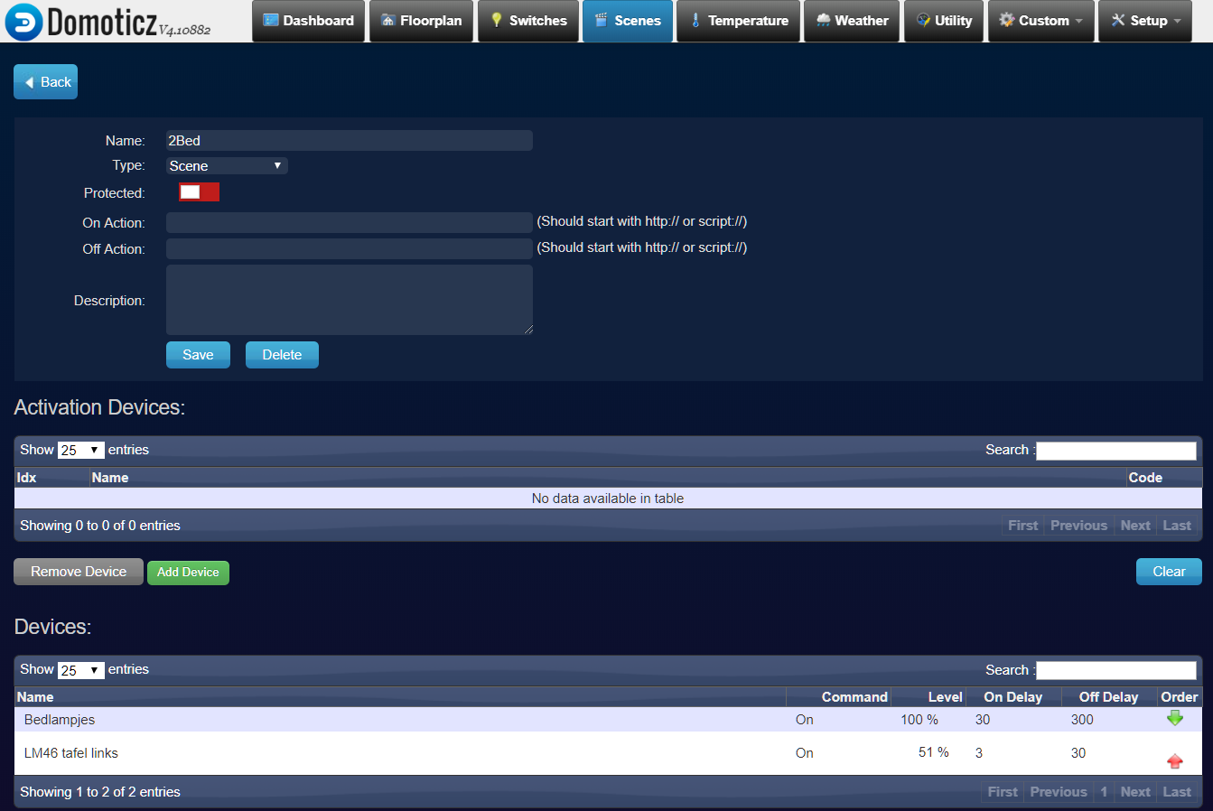

Hi I am a bit new to Domiticz and I have figured out quite a lot.
I understand how I can create scenes
I also want to use the random function to hide absense.
Nu I want to create a scene with the folowing settings
It is called "to bed" and in the devices I have:
Woonkamer Ledstrip Off 51 % 0 0
Slaapkamerlamp On 100 % 30 300
I did some test where I switch on the light at a certain time and an off delay set at 300 sec.
I have that light on the timer and it turns on as expected but it does not switch of after 300 sec.
:o
what I programmed for this test:
Name State Level On Delay Off Delay Order
Woonkamer Ledstrip - 84 % 0 300
I expected this to be on for 5 minutes
Where did I understand this wrong?

bhennink wrote: Monday 10 June 2019 17:39 Now I want to create a scene
I do not quite understand what you mean but this scene switch the 'Bedlampjes' On after 30 seconds and to Off after 300 seconds and the 'LM46 tafel links' to On after 3 seconds and to Off after 30 seconds.

I think the problem is that the woonkamer ledstrip was used twice with the Off delay at different values.
I have the feeling it is working now, but need to do some more testing
