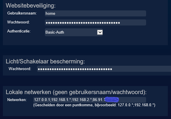

My authentication is also set to basic-auth. Using the CURL-command from the commandline on my rPi does spit out a ton of result which looks like an HTML-page to me (text-version of course), so the port does seem to be open.
Using your adapted script (after correcting the error in switch-name you so sharply found, thx) generates the following log:

bldewit wrote: Wednesday 19 June 2019 20:25 Using the CURL-command from the commandline on my rPi does spit out a ton of result which looks like an HTML-page to me (text-version of course), so the port does seem to be open.
Kind of puzzled by this. Seems to me there must be a difference in setup on your system compared to mine and other users of this script.
Can you enter the curl commands in the code window from the CLI and post the results (via PM) and remove any sensitive stuff.
Both commands should return a (potential big) JSON string.

Well, the answer seems to be clear: Unauthorized!
<html><head><title>Unauthorized</title></head><body><h1>401 Unauthorized</h1></body></html>
So, no logliines to process, so no output....
But next: What is the solution.... :?:
Re: Use an error in log as a trigger
Posted: Friday 28 June 2019 16:22
by waaren
bldewit wrote: Friday 28 June 2019 14:35 Well, the answer seems to be clear: Unauthorized!
Based on the config you showed it's still unclear to me.
To make sure I completely understand what you did. You logged on to the system where domoticz is running and gave the curl command ?
What do you see when you entere these commands from the CLI on the domoticz system ?
ps -ef | grep domoticz
netstat -nao | grep 127.0
ping -c5 -4 localhost
nmap 127.0.0.1
ifconfig | grep 127
Posted: Sunday 30 June 2019 9:43
by bldewit
pi@UniPi:~ $ ps -ef | grep domoticz
root 373 1 8 jun10 ? 1-15:18:33 /home/pi/domoticz/domoticz -daemon -www 8079 -sslwww 442
pi 12416 12388 0 09:38 pts/0 00:00:00 grep --color=auto domoticz
pi@UniPi:~ $ netstat -nao | grep 127.0
tcp 0 0 127.0.0.1:49928 127.0.0.1:42477 ESTABLISHED off (0.00/0/0)
tcp 0 0 127.0.0.1:42477 127.0.0.1:49928 ESTABLISHED off (0.00/0/0)
pi@UniPi:~ $ ping -c5 -4 localhost
PING localhost (127.0.0.1) 56(84) bytes of data.
64 bytes from localhost (127.0.0.1): icmp_seq=1 ttl=64 time=0.191 ms
64 bytes from localhost (127.0.0.1): icmp_seq=2 ttl=64 time=0.299 ms
64 bytes from localhost (127.0.0.1): icmp_seq=3 ttl=64 time=0.270 ms
64 bytes from localhost (127.0.0.1): icmp_seq=4 ttl=64 time=0.263 ms
64 bytes from localhost (127.0.0.1): icmp_seq=5 ttl=64 time=0.214 ms
--- localhost ping statistics ---
5 packets transmitted, 5 received, 0% packet loss, time 4103ms
rtt min/avg/max/mdev = 0.191/0.247/0.299/0.041 ms
pi@UniPi:~ $ nmap 127.0.0.1
-bash: nmap: opdracht niet gevonden
pi@UniPi:~ $ ifconfig | grep 127
inet 127.0.0.1 netmask 255.0.0.0
Posted: Sunday 30 June 2019 10:14
by waaren
bldewit wrote: Sunday 30 June 2019 9:43 pi@UniPi:~ $ nmap 127.0.0.1
Use this command to install nmap on your pi
sudo apt install nmap
the nmap wil show which ports can be accessed so it will be useful to see the result of the nmap 127.0.0.1 command
Can you also have a look in your /etc/hosts file to check if it contains
127.0.0.1       localhost
::1             localhost ip6-localhost ip6-loopback
Posted: Tuesday 02 July 2019 23:31
by bldewit
OK, the loopbacks are in the HOSTS-file, but I'm hitting a big stop-sign on nmap. When installing nmap my Pi also wants to uninstall Unifi, a software package from Ubiquiti. From past experience on this particular configuration I know that uninstalling Unifi will brick my config....
My only alternative would be to do a clean install for this rPi of install everything on a nanopi neo and see where that takes me....
It will take some time to get there though...
Any suggestions without using nmap?
Posted: Wednesday 03 July 2019 0:23
by waaren
bldewit wrote: Tuesday 02 July 2019 23:31 Any suggestions without using nmap?
What I try to find is the reason why a command that works for me and more users of dzVents, does not work on your system. the nmap command is needed to check if your domoticz port is accessible from the system itself. From your earlier reply I get the impression that the response you get from the curl command is not from the domoticz process.
So if you have an other way of doing that ?
Posted: Wednesday 03 July 2019 23:55
by bldewit
Because of the Unifi software on this rPi i did tell Domoticz to use a different port than the default one. This was done during the installation procedure, though....
Might this be the cause?
Otherwise I will really have to try a complete reinstall. That will take some time though, so this thread might go silent for a while in that case...
