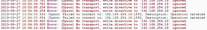

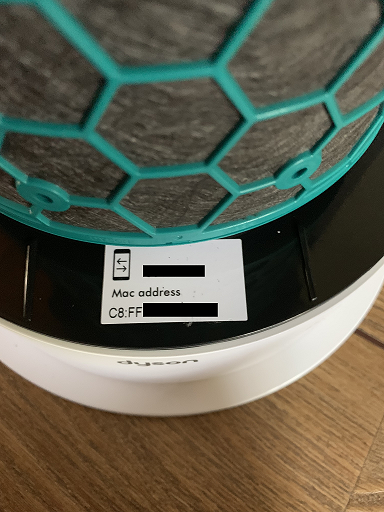

I'm trying to use your plugin but it's not working
I think it has to do with the password but I'm not sure.
My device has a sticker behind the filter that has the Mac address and also a mobile phone picture with arrows indicating data exchange and a code behind it. This is the only thing I can find that looks like the password. I added the hardware with the following settings: I get the additional devices in the list but the logs show the following: What goes wrong?

JanJaap
- Posts: 245
- Joined: Thursday 12 October 2017 20:46
- Domoticz version: Dev
- Location: the Netherlands
Re: Python plugin: Dyson pure link
Sorry for late reply I wasn't watching this forum......
First, this device doesn't look like my 475 model. The error points to either no network connection or password incorrect. I needed the password at the initial setup of the machine. Did you need that as well?
See also the extended wiki on github.

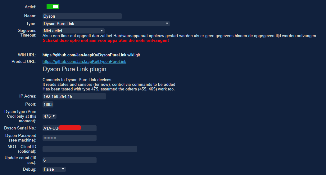

This is not the "Link" Modell. The new ones, with the new status display, are just called dyson pure cool. Now the App connects over Bluetooth, so there is no password on the device.Mozart wrote: Thursday 27 June 2019 11:00 I'm trying to use your plugin but it's not working
What goes wrong?
As your Post was from January, did you find any solution in between?

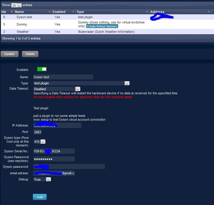

Well, I did do some tests with connections to new models, however, since I have only an old one I'm looking for testers
See discussion on the plugin github. I created a test plugin to see if I can get the credentials from the Dyson cloud account, see test plugin.
I'd be really interested to see what the response is on your case. The test plugin will try to connect to the machineand fetch its status when it connects. Works fine on my old model.

well, I tested the plugin with the settings as follows: but no devices are accessable.JanJaap wrote: Thursday 26 September 2019 20:24 Well, I did do some tests with connections to new models, however, since I have only an old one I'm looking for testers
log file:
2020-04-14 17:30:01.709 (Dyson ) MqttClient::Failed to connect to: 192.168.0.131:1883, Description: No route to host
2020-04-14 17:30:06.734 (Dyson test) Pushing 'onHeartbeatCallback' on to queue
2020-04-14 17:30:06.769 (Dyson test) Processing 'onHeartbeatCallback' message
2020-04-14 17:30:06.769 (Dyson test) Calling message handler 'onHeartbeat'.
2020-04-14 17:30:06.769 (Dyson test) onHeartbeat called
2020-04-14 17:30:11.729 (Dyson ) MqttClient::Failed to connect to: 192.168.0.131:1883, Description: No route to host
2020-04-14 17:30:16.736 (Dyson test) Pushing 'onHeartbeatCallback' on to queue
2020-04-14 17:30:16.739 (Dyson test) Processing 'onHeartbeatCallback' message
2020-04-14 17:30:16.739 (Dyson test) Calling message handler 'onHeartbeat'.
2020-04-14 17:30:16.739 (Dyson test) onHeartbeat called
2020-04-14 17:30:21.699 (Dyson ) MqttClient::Failed to connect to: 192.168.0.131:1883, Description: No route to host
2020-04-14 17:30:26.737 (Dyson test) Pushing 'onHeartbeatCallback' on to queue
2020-04-14 17:30:26.759 (Dyson test) Processing 'onHeartbeatCallback' message
2020-04-14 17:30:26.759 (Dyson test) Calling message handler 'onHeartbeat'.
2020-04-14 17:30:26.759 (Dyson test) onHeartbeat called
2020-04-14 17:30:31.719 (Dyson ) MqttClient::Failed to connect to: 192.168.0.131:1883, Description: No route to host
2020-04-14 17:30:36.739 (Dyson test) Pushing 'onHeartbeatCallback' on to queue
2020-04-14 17:30:36.779 (Dyson test) Processing 'onHeartbeatCallback' message
2020-04-14 17:30:36.779 (Dyson test) Calling message handler 'onHeartbeat'.
2020-04-14 17:30:36.779 (Dyson test) onHeartbeat called
2020-04-14 17:30:41.689 (Dyson ) MqttClient::Failed to connect to: 192.168.0.131:1883, Description: No route to host
2020-04-14 17:30:46.741 (Dyson test) Pushing 'onHeartbeatCallback' on to queue
2020-04-14 17:30:46.749 (Dyson test) Processing 'onHeartbeatCallback' message
2020-04-14 17:30:46.749 (Dyson test) Calling message handler 'onHeartbeat'.
2020-04-14 17:30:46.749 (Dyson test) onHeartbeat called
2020-04-14 17:30:51.709 (Dyson ) MqttClient::Failed to connect to: 192.168.0.131:1883, Description: No route to host
2020-04-14 17:30:56.743 (Dyson test) Pushing 'onHeartbeatCallback' on to queue
2020-04-14 17:30:56.769 (Dyson test) Processing 'onHeartbeatCallback' message
2020-04-14 17:30:56.769 (Dyson test) Calling message handler 'onHeartbeat'.
2020-04-14 17:30:56.769 (Dyson test) onHeartbeat called
with the original plugin, I have the same issue as JollyRoger68, I see the devices, but they are not active (f.e. 0°C and hum 50%)
if I can help further, let me know.

2020-10-22 18:09:19.895 (Dyson) 47 78 49 41 74 47 36 38 41 6d 71 55 39 36 41 36 79 43 4a 4c GxIAtG68AmqU96A6yCJL
2020-10-22 18:09:19.895 (Dyson) 4c 36 6c 35 69 70 39 7a 56 50 4e 58 75 6b 48 67 73 2f 41 3d L6l5ip9zVPNXukHgs/A=
2020-10-22 18:09:19.895 (Dyson) 3d .. .. .. .. .. .. .. .. .. .. .. .. .. .. .. .. .. .. .. =
2020-10-22 18:09:19.333 Status: (Dyson) Entering work loop.
2020-10-22 18:09:19.334 Status: (Dyson) Initialized version 2.3.6, author 'Jan-Jaap Kostelijk'
2020-10-22 18:09:20.260 (Dyson) Queued asynchronous read aborted (192.168.1.14:1883), [2] End of file.
2020-10-22 18:09:20.296 (Dyson) Received 4 bytes of data
2020-10-22 18:09:20.296 (Dyson) 20 02 00 05 .. .. .. .. .. .. .. .. .. .. .. .. .. .. .. .. ....
2020-10-22 18:09:20.296 (Dyson) Disconnect event received for '192.168.1.14:1883'.
2020-10-22 18:09:20.296 (Dyson) MqttClient::onMessage Topic '', Data[Verb]: 'CONNACK'
2020-10-22 18:09:20.296 (Dyson) onMQTTConnected called
2020-10-22 18:09:20.296 (Dyson) MQTT connection established
2020-10-22 18:09:20.296 (Dyson) MqttClient::Subscribe
2020-10-22 18:09:20.297 (Dyson) MqttClient::Publish 455/PT4-EU-KKA0925A/command ({"msg": "REQUEST-CURRENT-STATE", "time": "2020-10-22T16:09:20Z"})
2020-10-22 18:09:20.297 (Dyson) MqttClient::onDisonnect Disconnected from: 192.168.1.14:1883
2020-10-22 18:09:20.297 (Dyson) MqttClient::Close
2020-10-22 18:09:20.297 (Dyson) onMQTTDisconnected
2020-10-22 18:09:20.297 (Dyson) Deallocating connection object '192.168.1.14' (192.168.1.14:1883).
2020-10-22 18:09:20.297 Error: (Dyson) No transport, write directive to '192.168.1.14' ignored.
2020-10-22 18:09:29.366 (Dyson) Polling unit in 5 heartbeats.
2020-10-22 18:09:29.366 (Dyson) MqttClient::onHeartbeat
2020-10-22 18:09:29.366 (Dyson) MqttClient::Reconnecting
2020-10-22 18:09:29.366 (Dyson) MqttClient::Open
2020-10-22 18:09:29.366 (Dyson) MqttClient::Open: setup Domoticz connection object with protocol: 'MQTT'
2020-10-22 18:09:29.366 (Dyson) MqttClient::Open: open connection
2020-10-22 18:09:29.366 (Dyson) Protocol set to: 'MQTT'.
2020-10-22 18:09:29.366 (Dyson) Transport set to: 'TCP/IP', 192.168.1.14:1883.
2020-10-22 18:09:29.366 (Dyson) Connect directive received, action initiated successfully.
2020-10-22 18:09:29.417 (Dyson) onConnect called: Connection 'Name: '192.168.1.14', Transport: 'TCP/IP', Protocol: 'MQTT', Address: '192.168.1.14', Port: '1883', Baud: -1, Bytes: 0, Connected: True, Last Seen: 2020-10-22 18:09:29, Parent: 'None'', Status: '0', Description: 'Success'
2020-10-22 18:09:29.417 (Dyson) MqttClient::onConnect
2020-10-22 18:09:29.417 (Dyson) MqttClient::MQTT connected successfully.
2020-10-22 18:09:29.417 (Dyson) MqttClient::Connect
2020-10-22 18:09:29.417 (Dyson) MqttClient::MQTT CONNECT ID: 'Domoticz_1603382959'
2020-10-22 18:09:29.417 (Dyson) Sending 141 bytes of data
2020-10-22 18:09:29.417 (Dyson) 10 8a 01 00 04 4d 51 54 54 04 c2 00 3c 00 13 44 6f 6d 6f 74 .ʮ..MQTT.®<..Domot
2020-10-22 18:09:29.417 (Dyson) 69 63 7a 5f 31 36 30 33 33 38 32 39 35 39 00 0f 50 54 34 2d icz_1603382959..PT4-
2020-10-22 18:09:29.417 (Dyson) 45 55 2d 4b 4b 41 30 39 32 35 41 00 58 75 33 59 72 34 43 46 EU-KKA0925A.Xu3Yr4CF
2020-10-22 18:09:29.417 (Dyson) 74 73 30 79 52 45 2b 56 74 51 31 74 34 31 42 59 63 4b 44 7a ts0yRE+VtQ1t41BYcKDz
2020-10-22 18:09:29.417 (Dyson) 33 77 59 59 54 30 74 39 43 7a 6c 55 45 50 73 58 79 6b 76 79 3wYYT0t9CzlUEPsXykvy
2020-10-22 18:09:29.417 (Dyson) 47 78 49 41 74 47 36 38 41 6d 71 55 39 36 41 36 79 43 4a 4c GxIAtG68AmqU96A6yCJL
2020-10-22 18:09:29.417 (Dyson) 4c 36 6c 35 69 70 39 7a 56 50 4e 58 75 6b 48 67 73 2f 41 3d L6l5ip9zVPNXukHgs/A=
2020-10-22 18:09:29.418 (Dyson) 3d .. .. .. .. .. .. .. .. .. .. .. .. .. .. .. .. .. .. .. =
2020-10-22 18:09:29.421 (Dyson) Queued asynchronous read aborted (192.168.1.14:1883), [2] End of file.
2020-10-22 18:09:29.468 (Dyson) Received 4 bytes of data
2020-10-22 18:09:29.468 (Dyson) 20 02 00 05 .. .. .. .. .. .. .. .. .. .. .. .. .. .. .. .. ....
2020-10-22 18:09:29.468 (Dyson) Disconnect event received for '192.168.1.14:1883'.
2020-10-22 18:09:29.468 (Dyson) MqttClient::onMessage Topic '', Data[Verb]: 'CONNACK'
2020-10-22 18:09:29.468 (Dyson) onMQTTConnected called
2020-10-22 18:09:29.468 (Dyson) MQTT connection established
2020-10-22 18:09:29.468 (Dyson) MqttClient::Subscribe
2020-10-22 18:09:29.469 (Dyson) MqttClient::Publish 455/PT4-EU-KKA0925A/command ({"msg": "REQUEST-CURRENT-STATE", "time": "2020-10-22T16:09:29Z"})
2020-10-22 18:09:29.469 (Dyson) MqttClient::onDisonnect Disconnected from: 192.168.1.14:1883
2020-10-22 18:09:29.469 (Dyson) MqttClient::Close
2020-10-22 18:09:29.469 (Dyson) onMQTTDisconnected
2020-10-22 18:09:29.469 (Dyson) Deallocating connection object '192.168.1.14' (192.168.1.14:1883).
2020-10-22 18:09:29.469 Error: (Dyson) No transport, write directive to '192.168.1.14' ignored.
