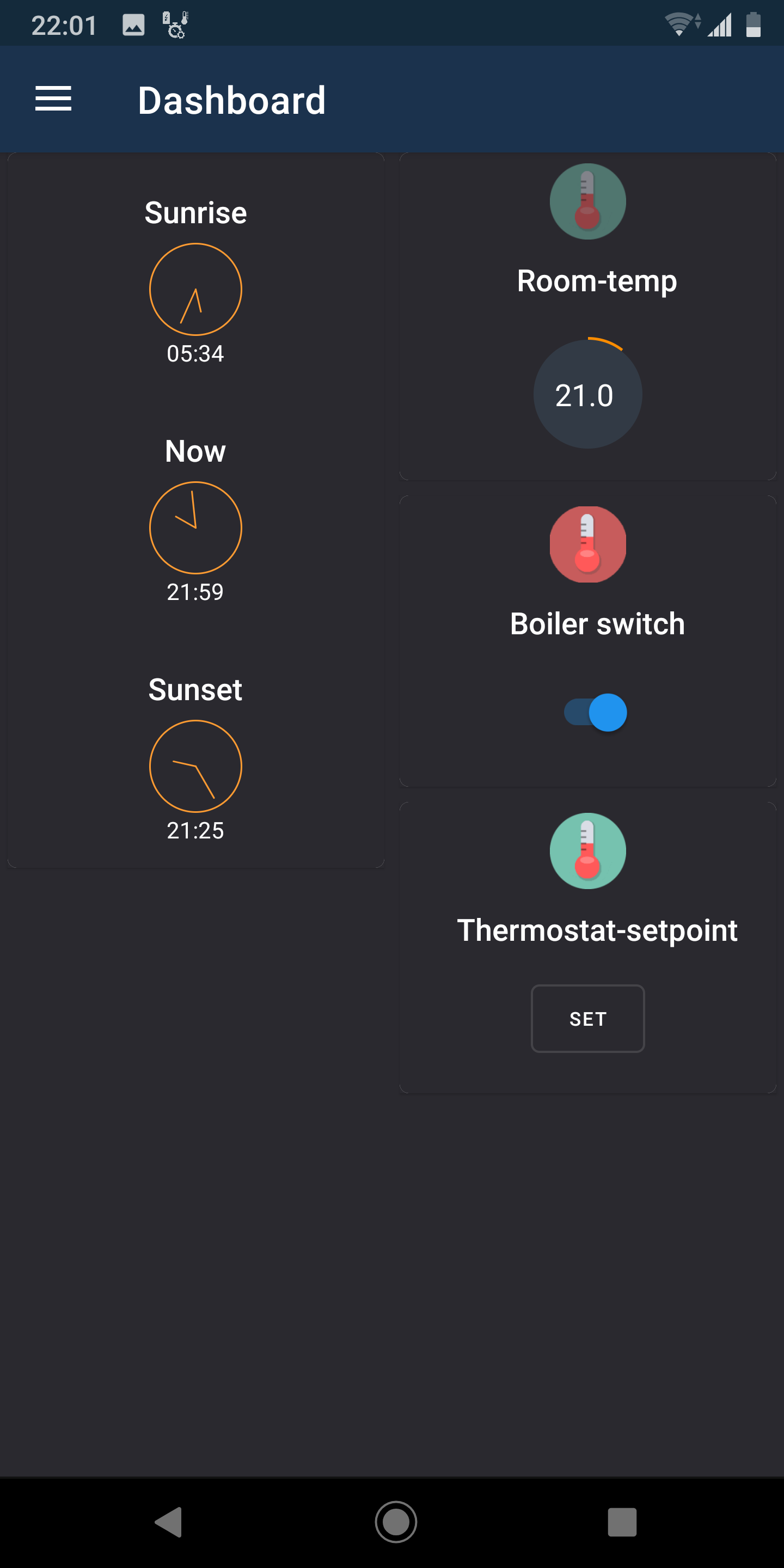

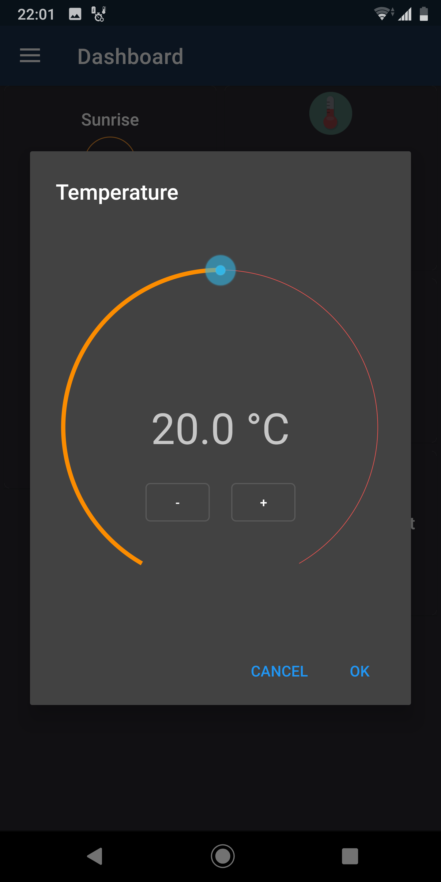

What I had discovered on Domoticz was Virtual Switches and Thermostat setpoint. Adding the information from a thermometer it was straightforward to write a python script.
Of course; I can set setpoints anytime, anywhere, start heating the house from the other side of the world. That could be achieved with the formentioned solutions as well.
New in this script is the time.sleep() function.
When the radiators are getting hot, the rise of the room temperature will be lagging a while.
What this script does is just wait, poll the temperature after 5 or 10 minutes and decide what it has to do next.
Instead of burning the temperature up all the way and overshooting it gives the same result as if a smart calculating procedure has been applied.
The result is less gas consumption and that is what I made this script for, besides long distance switching of course.
