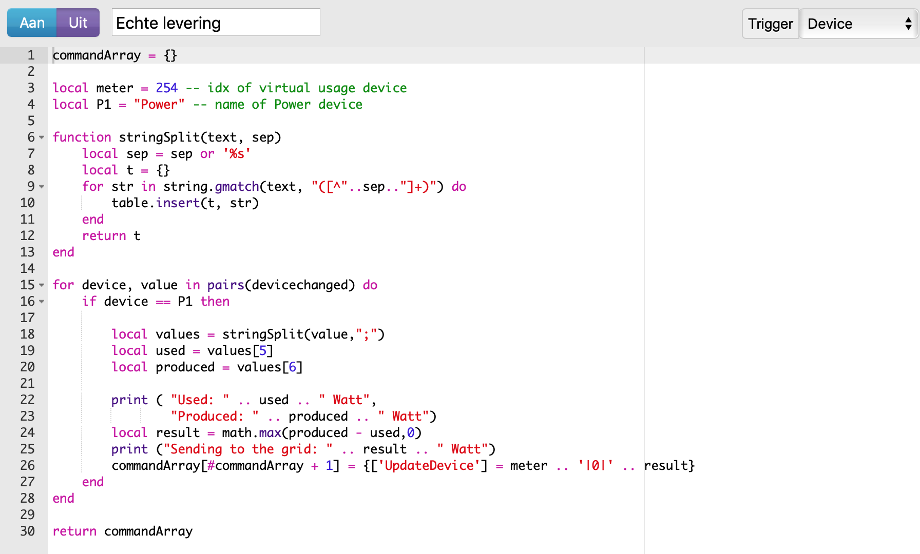

Hi, can someone help me with this Lua script, I can't get it to work.
local idx = 254
if (devicechanged['Power'] ~= meter) then
meter = devicechanged['Power']
--P1 meter uitsplitsen
power1, power2, power3, power4, power5, power6 = devicechanged['Power']:match("([^;]+);([^;]+);([^;]+);([^;]+);([^;]+);([^;]+)")
--Echte verbruik berekenen: verbruik - teruglevering
stroomverbruik = power5 - power6
commandArray[1] = {['UpdateDevice'] = idx .. '|0|' .. stroomverbruik}
local idx = 254

Could be something like
local meter = 1991 -- idx of virtual counter
local P1 = "Power" -- name of Power device
function stringSplit(text, sep)
local sep = sep or '%s'
local t = {}
for str in string.gmatch(text, "([^"..sep.."]+)") do
table.insert(t, str)
return t
for device, value in pairs(devicechanged) do
if device == P1 then
local values = stringSplit(value,";")
local used = values[5]
local produced = values[6]
print ( "Used: " .. used .. " Watt",
"Produced: " .. produced .. " Watt")
local result = used - produced
print ("From the grid: " .. result .. " Watt")
commandArray[#commandArray + 1] = {['UpdateDevice'] = meter .. '|0|' .. result}
return commandArray

Sure.Knibor wrote: Friday 10 May 2019 10:20 I have used the virtual sensor "Usage (Electric)" so that I have a readout in Watts.
Is it possible show only the positive values, so the values only when I deliver?
When I have "usage" it can stay on "0"
local meter = 1992 -- idx of virtual usage device
local t = {}
return t
local result = math.max(produced - used,0)
print ("Sending to the grid: " .. result .. " Watt")
return commandArray

2019-05-10 22:04:00.831 Error: EventSystem: in Echte levering: [string "commandArray = {}..."]:15: bad argument #1 to 'pairs' (table expected, got nil)
Dit i do something wrong?
I copy paste the script and only changed the IDX number.
I have an error in the Log file.
- waaren
- Posts: 6028
Re: Real consumption
Have you saved it as a Lua device type script ?
Added test for that
local t = {}
return t
if not devicechanged then
print ("No devices seem to have changed. did you save the script as type device ?")
return commanddArray
return commandArrayDebian buster, bullseye on RPI-4, Intel NUC.

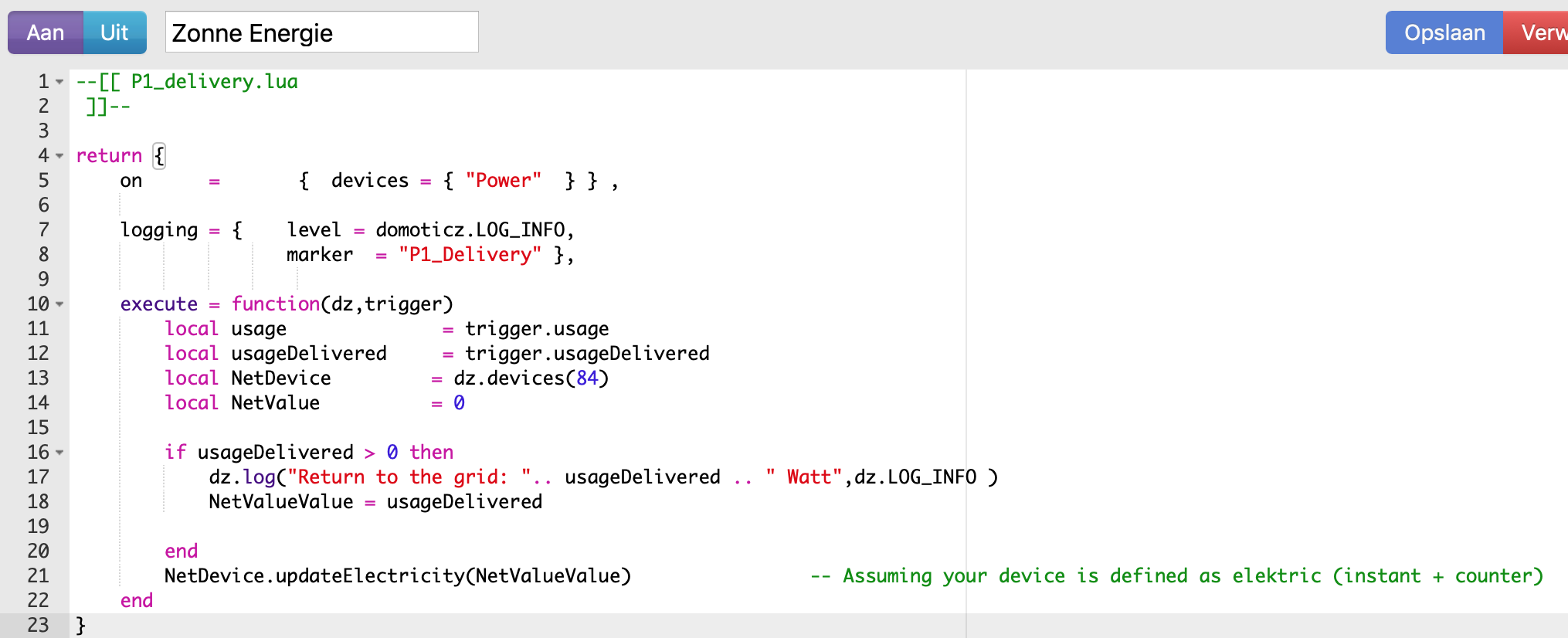

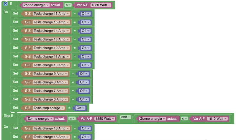

Hi, Thanks for the example script, but I have a problem to get it work in conjunction with "Blockly"
It has the name "Echte stroom" with IDX 254
When I use this script, I have a readout on a virtual device "Echte stroom" but when I use the virtual name "Echte stroom" in a "Blockley" program, the program will not work.
But when I use the virtual device "Zonne energie" with IDX 84 in the "Blockley" program it works!
With device IDX 84, I measure only the total delivery of the 3 fase, but with IDX 254 the deference of (usage and delivery) of the 3 fase meter.
It this problem to solve?

- waaren
- Posts: 6028
I don't see why not but fail to understand why you want to mix three different type of code (Blockley, dzVents and Lua) to handle your requirements.
Happy to help but with a preference for a solution where you use dzVents from start to finish.
So if you can send me a PM with a description of your requirements, physical and virtual sensortypes and switches I can have a look.
PM can be in Dutch and I always share the end-result on the forum to enable other members to cherry-pick from it.
