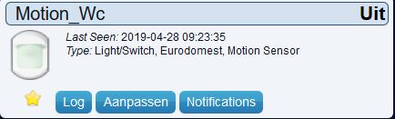

i ordered a rflink to connect my smoke detectors with it.
this works fine so i thought to add some cheap switches(no prior) to it instead of my zwave switches.
So i bought a KERUI P817 433MHz motion sensor to light up my toilet lamp.
I notice that every time the sensor got triggerd i only see a OFF event
i used the learn button in devices and i try it with accept devices for 5 min.
My zwave device's got an on and off event.
I fixed this now by say in my blocky "when device is off then" and this works but now i want to extend it but in need the on/off
How can i fix this?
and this is a part of the log
2019-04-28 09:23:35	Off
2019-04-28 09:19:11	Off
2019-04-28 09:19:02	Off
2019-04-28 09:18:56	Off
2019-04-28 08:43:15	Off
2019-04-27 21:09:16	Off
2019-04-27 21:09:09	Off
2019-04-27 20:55:04	Off
2019-04-27 20:54:57	Off
2019-04-27 20:54:51	Off
2019-04-27 20:52:02	Off
2019-04-27 20:50:47	Off
2019-04-27 20:49:52	Off
2019-04-27 20:49:45	Off

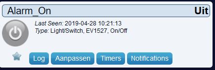

The second device is a wall switch
KTNNKG 1 kanaal 433 MHz 86 wandcontact
This device is also add tot domoticz but this wall switch sent only a on command.
When i touch the button again id do not get a off event so i cannot set the light bulb off.
i my domoticz log i see(i add a event to test)
 2019-04-28 10:17:43.424 (RF_433) Temp + Humidity (Temp_Buiten)
2019-04-28 10:17:50.866 (RF_433) Light/Switch (Alarm_On)
2019-04-28 10:17:51.097 EventSystem: Event triggered: test alarm_1
2019-04-28 10:17:51.118 OpenZWave: Domoticz has send a Switch command! NodeID: 3 (0x03)
2019-04-28 10:17:51.123 (Controller) Light/Switch (Lichten_Eetplaats)
2019-04-28 10:17:56.342 (RF_433) Light/Switch (Alarm_On)
2019-04-28 10:17:56.560 EventSystem: Event triggered: test alarm_1
2019-04-28 10:18:09.142 (RF_433) Light/Switch (Alarm_On)
2019-04-28 10:18:09.301 EventSystem: Event triggered: test alarm_1
and in the device log
2019-04-28 10:18:09	On
2019-04-28 10:17:56	On
2019-04-28 10:17:50	On
2019-04-28 10:10:36	Off
2019-04-28 09:54:59	On
2019-04-28 09:54:55	On
2019-04-28 09:54:50	On
2019-04-28 09:54:42	On
2019-04-28 09:54:36	On
2019-04-28 09:41:29	On
2019-04-28 09:41:23	On
so do i need to go back to zwave to get this work?
