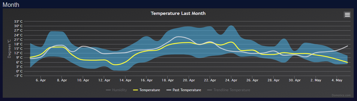

Okey, seems this was done in the past...
We can configure the chart with some options:
alignTicks: false,
tickInterval: 0.5
This results in:

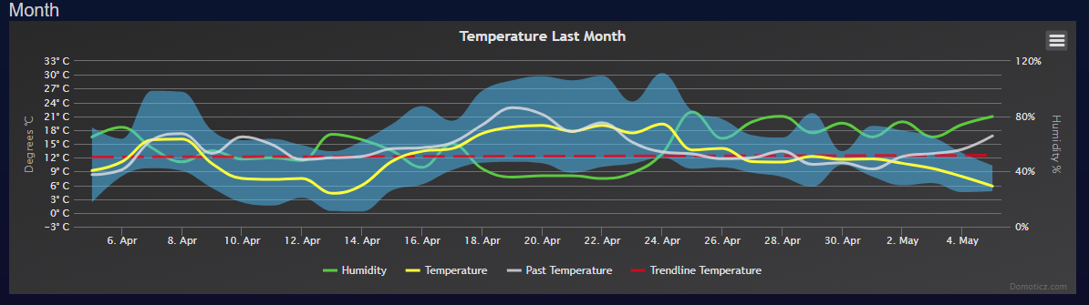

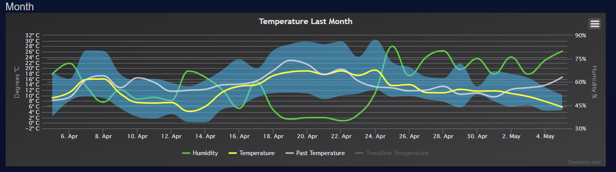

but now when enabling the Humidity the result is maybe a bit messy with the grid lines:

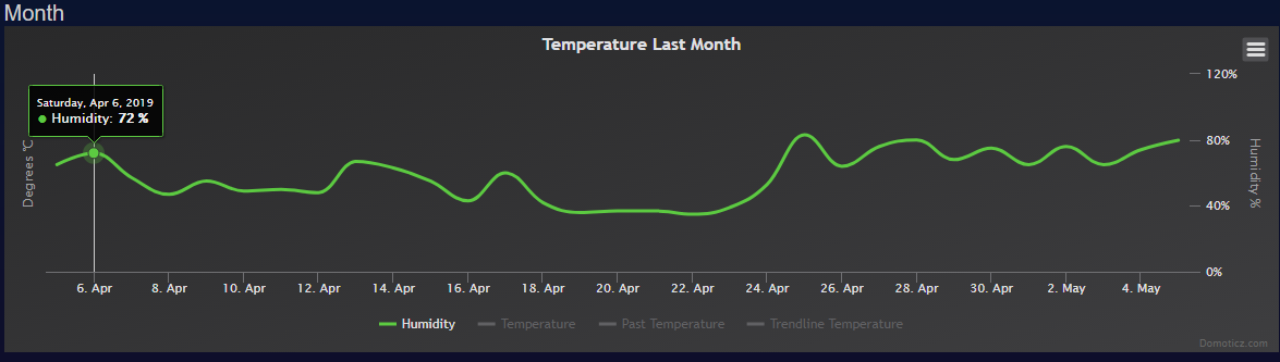

We can hide the gridlines always from the Humidity graph:
Without temp the humidity would then look like:
Whats preferred ? (ps. the 120% is still considered to be a bug in highchart...)

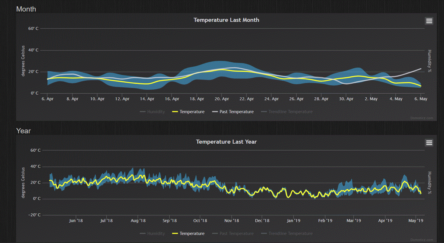

I don't use very often graphs with Humidity value. Below are two examples with temperature only. To have usable graphs, the scale of the temperature graphs should be set (I think) accordingly to the min/max of the temperature. For example, for the "Temperature Last Year" graph below, the scale should be between 0°C and +30°C and not between -20°C and + 60°C.
