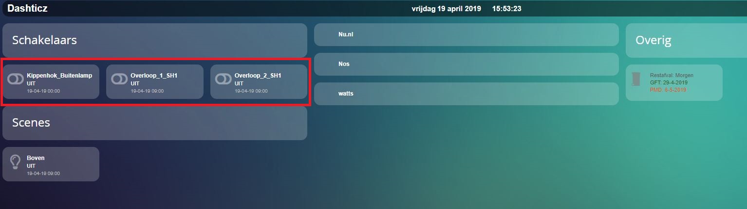

No, it comes to the light switches.
The behavior is, when i touch the button he is 5 seconds on or off and then he´s going automatic to his old status, without turning on-off the lights.
After i have cleaned the cash in chrome the switches are working. When i close dashticz_v2 and reopen dashticz_v2 it does the same again.
The switches are in the red square (see attachement)
Lokonli
Posts: 2292
Re: Button Switches doesn't react in dashticz_v2
Post by Lokonli »
Doorus wrote: Friday 19 April 2019 16:04 No, it comes to the light switches.
Please check your PM.
