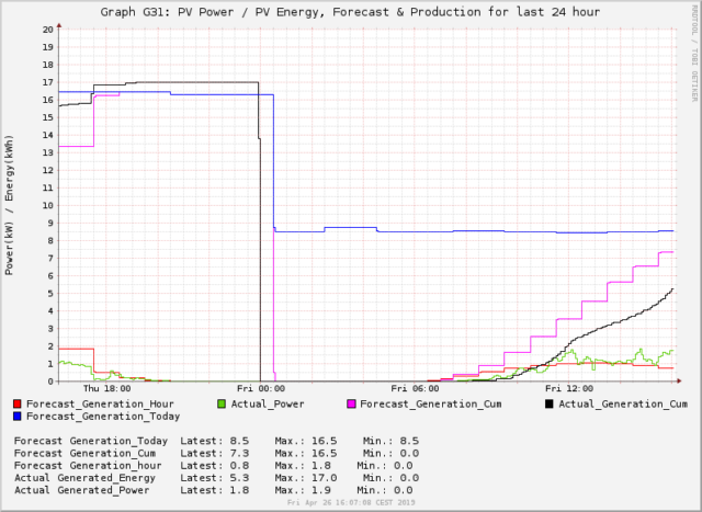

Based on personal experience/preference and available source-info, experimenting with a lua-script operating on the XML-files originating from forecast.solar.
First experiment operating on the Wh_per_day file:
#0 download of the XML_string
#1 find the start & end of each value-segment
a. definition of search-string
b. perform search to get position references
#2 extract contents from the value segments
#3 convert contents into output to Domoticz
The start-section of my script for #0 provides in Domoticz' Log from a printcommand a nicely formatted XML-string:
that seems sign that download-output is OK.
For Step #1 the relevant 1st part of the script
-- Line 069, Make Search-strings for Date&Time; filled with info from date = os.date("*t")

Some fiddling with scripts and RRDTool resulted in a comparison-graph:
- the blue line is the forecasted 'PV-goal' per day
- the red and green lines are respectively the forecasted and actual power/energy values per hour
- the purple and black line are in the same way the accumulating energy values over the day
At the end of the day these latter 2 lines should be close to the blue line.
PV_Comparison_Graph
PV_Comparison_Graph
pipowerPVF1_20190426 [640x480].png (114.42 KiB) Viewed 5000 times
The background data may be correct, but in practise the resulting picture is a bit 'strange':
- the PV-forecasts are refreshed per hour in relation to the actual meteo-forecast in that hour
Refresh & fluctuations show as distinct steps.
- the actual PV_Power and actual PV_Energy in comparison are very detailed.
Conclusion: other (more appealing) way of presentation needed without those 'steps'.
For cloudy days sometimes the gap between Forecast and Practise is 'rather large'.
On the other hand, those 'steps' are clear visual sign that the estimation of values has a limited accuracy, and that such graphline is not 'the absolute truth'.

2. To my opinion the following should be in W(atts) instead of kWh, because the table presents the electrical production at that specific time and not the energy produced over a specific time.
local solarEstimateCurrentHour = dz.devices(3136) -- Create this virtual sensor as "Custom Sensor" (x-as KWh)
You can simple change the X-ax to kW.
See the table for today:

If you want it to be presented as Watt instead of kW change the following line:
local thisHourWatt = dz.utils.round(watts[thisHour] / 1000,3)
to
local thisHourWatt = dz.utils.round(watts[thisHour])
