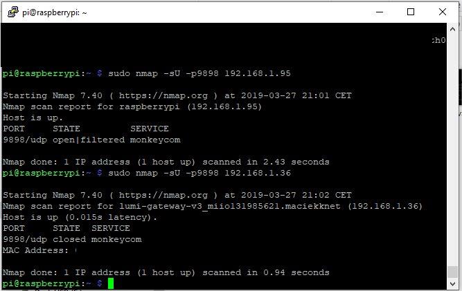

I'm still fighting but without success. I had several tries to reset gateway, domoticz, router etc. To be sure that there is no problem with my Rpi, I installed Domoticz (beta version) on my Lap with Windows 10. I added a user variable - no effect. I tried to find my gateway on the Rpi (Raspbian) by arp -a - I see this devices on the list (please see attached screen). Additional I check if port 9898 is open - by command: nmap -sU -p9898 Domoticz IP. I'm not sure if I put on the IP address as Domoticz IP or Gateway IP. In that two cases I see - Domoticz (192.168.1.95) that port is open| filtered, but in case I put Gateway IP (192.168.1.36) - port is closed. Please see screen.
Can You advise me, what I can do more to find a reason for no devices in Domoticz? I consider that subnet may be reason - I see that gateway is 255.255.255.0 (connected via WIFI), but I don't know how to check Domoticz subnet (connected via LAN. Info on the router is that lan is connected as 255.255.255.0) - so it should be no problem.

- upd port - open|filtered for domoticz, closed for gateway IP
- xiaomi_domo_xiaomi.jpg (40.83 KiB) Viewed 4651 times
- lumi.gateway.v3 found in arp -a
- lumi-gateway-v3 w arp.jpg (63.76 KiB) Viewed 4651 times

on new devicec and new firmware udp 9898 is closed. I have bought one ant this solution from openhub helped me
- Find specific screw bit like fork to open gateway case.
Find UART cable/board.
Solder 3 wires GND and RX / TX like here (Image .
Disconnect RX wire from UART module.
Dont connect Vcc (power) from UART to gateway.
Turn on gateway (220V).
Open putty application, connect to serial port (COM1-30) -select yours one0.
Wait for fully load of gateway, connect RX wire to UART.
You will see all messages of gateway.
Send command psm-set network.open_pf 3 , send it few time in case it was spammed by gateway and it can be lost in msgs…
Check your param by command psm-get network.open_pf to be sure its OK.
Turn off gateway.
Turn it ON.
Check your port.
