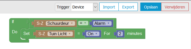

Now I want to test a simple blocky however the script does not respond, no matter which trigger I use in the blockly script.
The Idea is to turn on a lightswitch for 2 minutes when the door is opened
I have attached an screenshot of the script.
Also in the log the blockly script is not triggered, but the sensor is logged when the door is opened or closed:
2019-03-20 21:05:18.984 (RFXtrx433XL) Security (Schuurdeur)
Anybody an idea what is wrong

@ gschmidt the script is good, i have the same doorsensors by me working perfect but i think the rf signal is to far away , try the doorsensor in home and test if the script is working.
