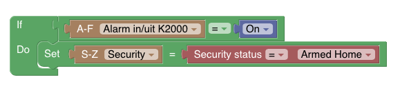

I've made this blocky to set my domoticz security in:
Alarm in/uit K2000 is a switch in domoticz connected to a K2000 panel.
I get this error in Domoticz log:
Error: EventSystem: Malformed action sequence!
I don't understand this. I should think its possible to switch my security with a blocky. Do I make a mistake?

I think the " security status = armed home " is a status that can not be set. I think it can only set something else.
If " security = armed home is on
Do set .......

That would be very disappointed. I do can switch my security with homekit/homebridge it should therefore be possible to switch my security in domoticz with a blocky or something? (I really hope so).
