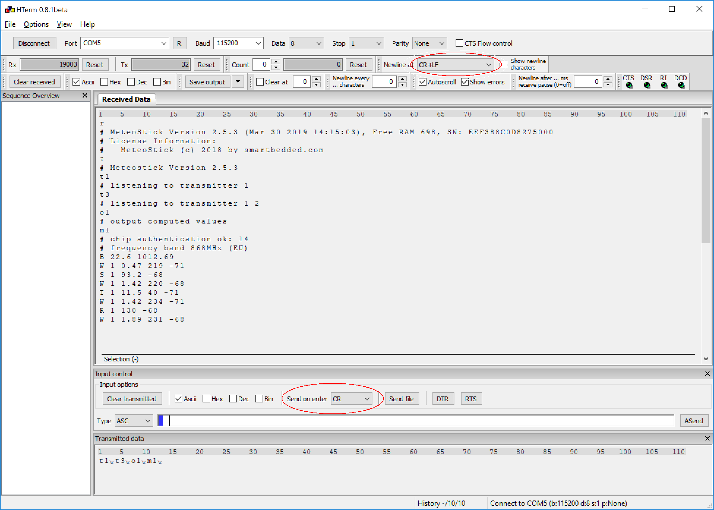

I plugged the meteostick into an USB port of my Windows PC and checked the device manager if it is recognized as a serial port.
(In my case it was COM 5)
I downloaded a serial terminal for my PC like HTerm http://www.der-hammer.info/terminal/ unzipped and started it.
COM 5 was automatically detected by HTerm.
Klick on Connect
For a better reading resp. sending data to the COM port:
  • In the RX section, i choosed "Newline at CR+LF"
    In the input options, i choosed send on "Enter CR"
see attachment:
HTerm mit MeteoStick.png (91.17 KiB) Viewed 2532 times
As described in the manual i entered
  • r to reset the meteostick
    t3 for transmitter ID 1 and 2
    o1 for the right format of the data
    and m1 to send the data.
If the ID of your anemometer transmitter is 2, then you should see its data after a while.
For a better reading you can enter o2 in the terminal window.
But for domoticz you need the o1 format.
I couldn't test it by myself, cause i don't have the anemometer transmitter yet.

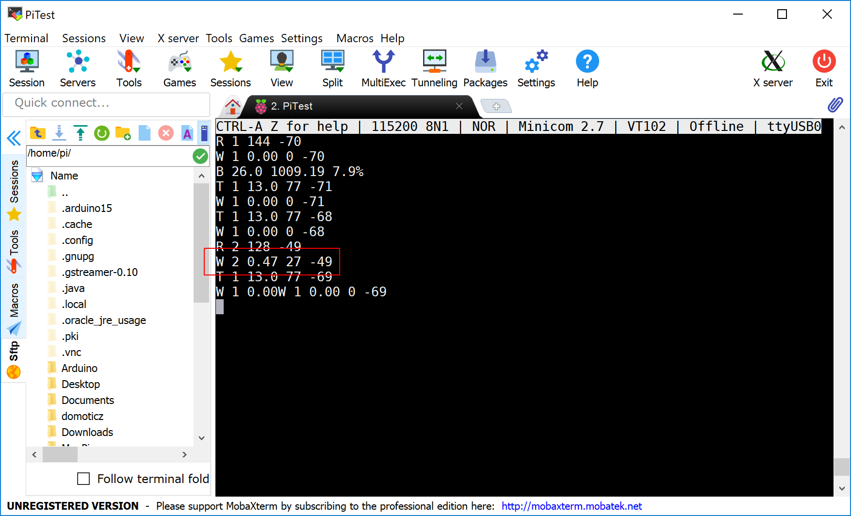

Meanwhile i got the transmitter for the anemometer, set it to ID 2 and checked its functionality.
It works with the Davis console.
Also the meteostick reports the signal (see minicom output)
minicom ausgabe.png (118.6 KiB) Viewed 2499 times

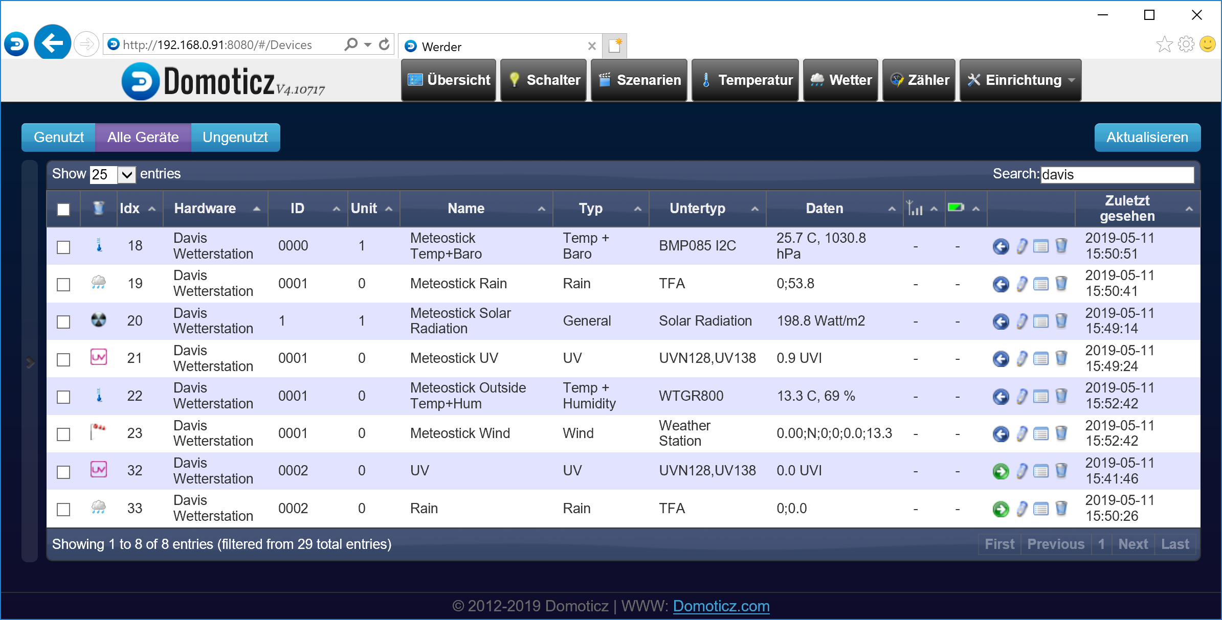

But Domoticz recognizes only an UV and a rain sensor on ID 2 (which are not connected)
meteostick in domoticz.png (250.22 KiB) Viewed 2499 times
So it seems that the problems lies inside Domoticz.
Seems we will have to pull a request in Github
