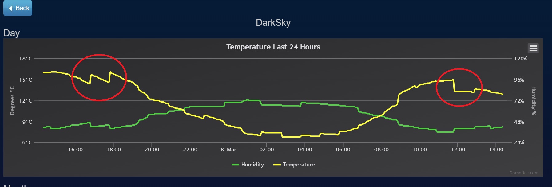

Post by pawel »
So I've tested both - DarkSky and AccuWeather. The first one works very strange in my location there are lots of spikes up and down for unknown reason (temp did not behave like this and I don't believe it can behave ever)
On the other hand AccuWeather seems to be more accurate but refresh rate once every 30 minutes is not enough for me :cry:
Weather underground was invaluable - precise and reliable...

Post by zicht »
I see the same.
Accuwether is not reliable at all, darksky strange spikes. Also the rain sensors have some strange habbits with negative values and cummulative and rates are not correct.
I also tried to scrape a local wether station that has a website (not WU) but also there it was raining long time, no values (after contact it turned out the rainsensor was not maintained)
So seems in my case the only thing to do is eighter to become a paying WU user or buy a rain sensor.
For principial reasons i will never pay WU as they use public gathered data, so my sensor will arrive by post next week.
(the reason not to do it was environmental : because the batterys it uses, Why to use an extra set of AA battery's when somebody allready has the values,..)
