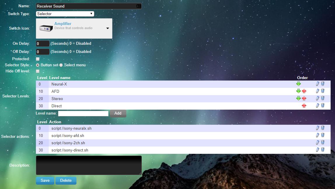

Now in Domoticz create a virtual button ("switch selector" in my case, since I want to use multiple scripts).
In "Level Action" you can now link to the script that you created, using:
script://sony-afd.sh
Swich Selector.JPG (99.74 KiB) Viewed 3204 times
