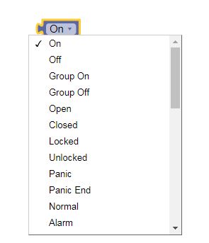

I've added th Xiaomi Switch (zigbee version) within Domoticz, but can't find the different states of the switch when using a Blocky script.
I guess I should be able to see "click", "double click", "long click" but these values does not exist within Blockly.
See attached
Does somebody have any idea how I could manage to fix this?
Thanks a lot in advance for you help! :)
Julien

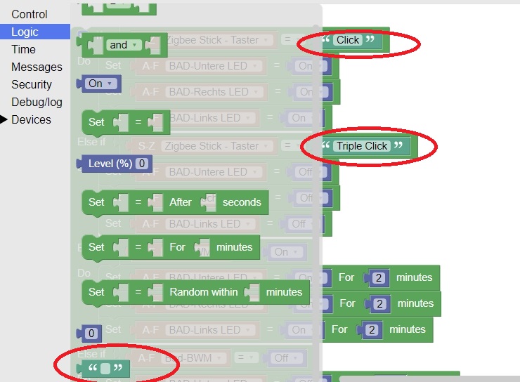

You have to take the building block (Logic) and enter the value yourself!
