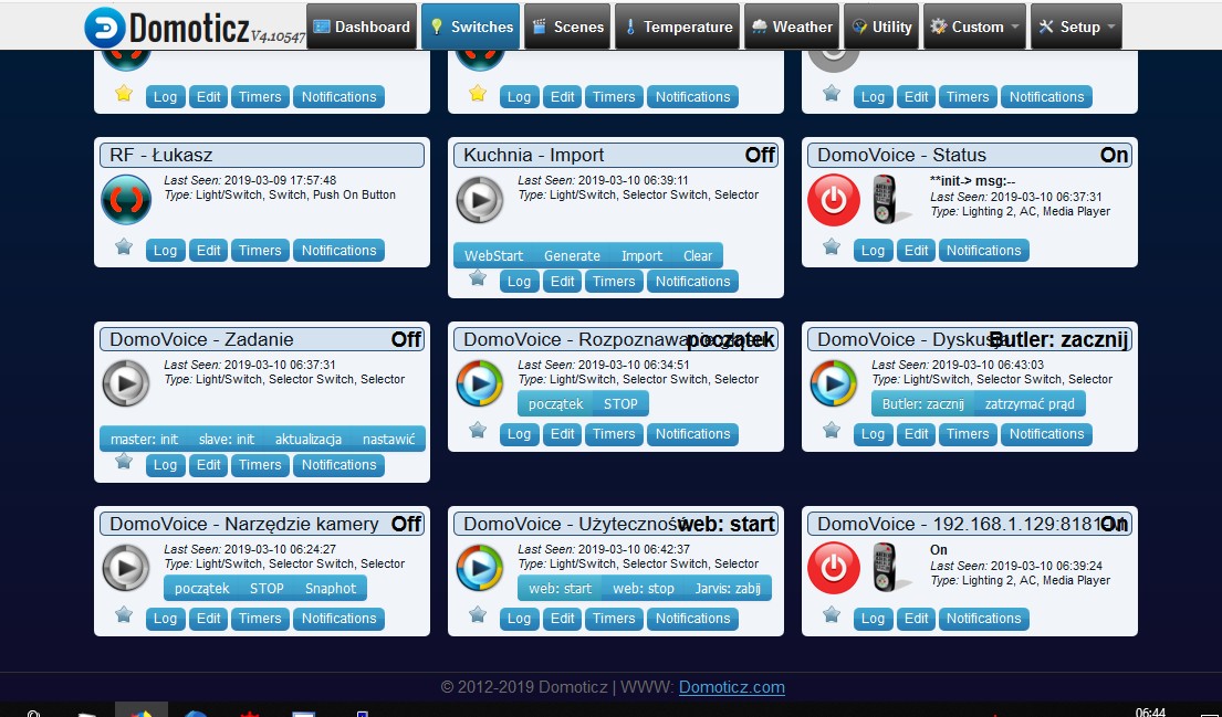

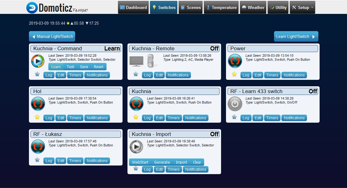

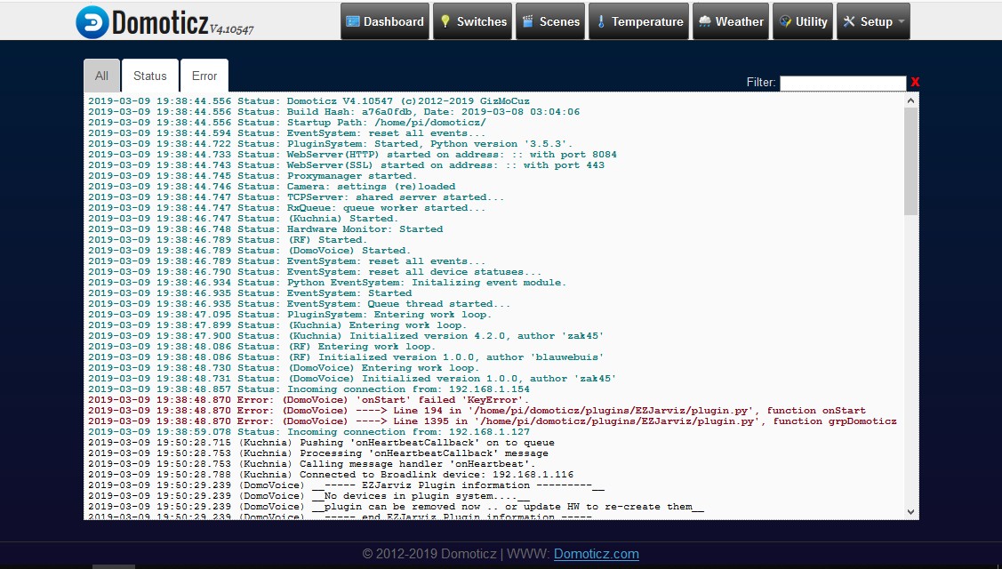

2019-03-09 19:38:48.870 Error: (DomoVoice) 'onStart' failed 'KeyError'.
2019-03-09 19:38:48.870 Error: (DomoVoice) ----> Line 194 in '/home/pi/domoticz/plugins/EZJarviz/plugin.py', function onStart
2019-03-09 19:38:48.870 Error: (DomoVoice) ----> Line 1395 in '/home/pi/domoticz/plugins/EZJarviz/plugin.py', function grpDomoticz at the end of the configuration, reports an error
You can hear a message on the phone about a configuration error
I do not have any DomoVoice switches in Switches
- switches.jpg (153.6 KiB) Viewed 2772 times
- log.jpg (232.98 KiB) Viewed 2772 times
- jarvis.jpg (129.21 KiB) Viewed 2772 times

@kniazio
can you put debug mode on, reload the plugin and post the log ?
thanks
edit:
have been able to reproduce the case:
2019-03-09 22:11:39.345 Status: (DomoticZVoiceZ) Initialized version 1.0.0, author 'zak45'
2019-03-09 22:11:39.347 Status: (DomoticZVoiceZ) Entering work loop.
2019-03-09 22:11:39.391 Error: (DomoticZVoiceZ) 'onStart' failed 'KeyError'.
2019-03-09 22:11:39.391 Error: (DomoticZVoiceZ) ----> Line 194 in '/home/usr/domoticz/plugins/EZJarviz/plugin.py', function onStart
2019-03-09 22:11:39.391 Error: (DomoticZVoiceZ) ----> Line 1395 in '/home/usr/domoticz/plugins/EZJarviz/plugin.py', function grpDomoticz
2019-03-09 22:11:49.386 (DomoticZVoiceZ - 192.168.1.21:8181-M) Updating device from 1:'On' to have values 0:'Off'.
2019-03-09 22:11:49.397 (DomoticZVoiceZ) __we update 0:'Off' (DomoticZVoiceZ - 192.168.1.21:8181-M)__
this happen when yo do not have any scene/group device...
let's try to manually create these two scenes :
InHome & OutHome
re-edit
new version uploaded to manage the case & additional feature included
just download and replace plugin.py & Jarviz.py
thanks
edit:
InHome & OutHome
re-edit

kniazio
- Posts: 204
- Joined: Thursday 06 October 2016 8:14
- Domoticz version: 3.7243
Re: Python Plugin : EZJarviz Voice command plugin
Thanks a lot
All devices in switches appeared
What this Custom page is for
Now you only have to learn how to handle it
- web.jpg (99.98 KiB) Viewed 2744 times
- dev.jpg (210.86 KiB) Viewed 2744 times

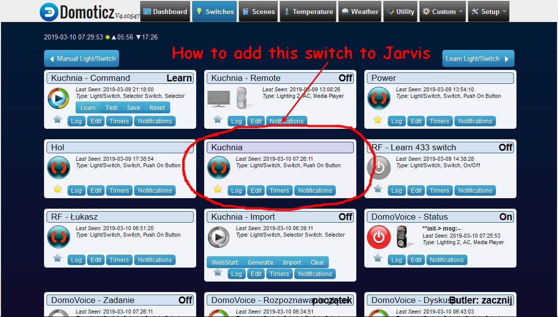

It would be nice to have step by step instructions on how to add Switch to Jarvis
- addswitch.jpg (206.94 KiB) Viewed 2741 times

all should be on the wiki.kniazio wrote: Sunday 10 March 2019 7:33 It would be nice to have step by step instructions on how to add Switch to Jarvis

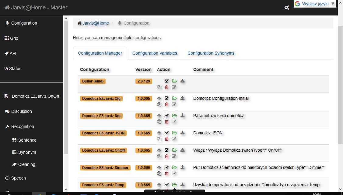

I can not add my own switch to Jarvis.
I want to issue commands in Polish.
I'm Polish
https://www.domoticz.com/forum/download ... p?id=19368
I'm Polish

Hummm .. maybe some misunderstanding:kniazio wrote: Sunday 10 March 2019 15:59 I can not add my own switch to Jarvis.
I'm Polish
"I can not add my own switch to Jarvis." : not enough information provided to be able to help you but.. if you speak about this device specifically
, this one is a push On button no ?? this type is not yet managed....workaround should be easy to implement.
"I want to issue commands in Polish.I'm Polish"
--> this should work for Polish language, so what's your problem here ???

I have a switch called "Kuchnia"
I turn it on in my kitchen.
What do you need to do to be able to control this switch with Jarvis?
zak45
- Posts: 954
- Joined: Sunday 22 January 2017 11:37
- Target OS: Windows
- Domoticz version: V2024.4
you can try by changing its type : put it as on/off and set a off after 2 sec. should do the trick.kniazio wrote: Sunday 10 March 2019 20:15 I have a switch called "Kuchnia"
let's try.

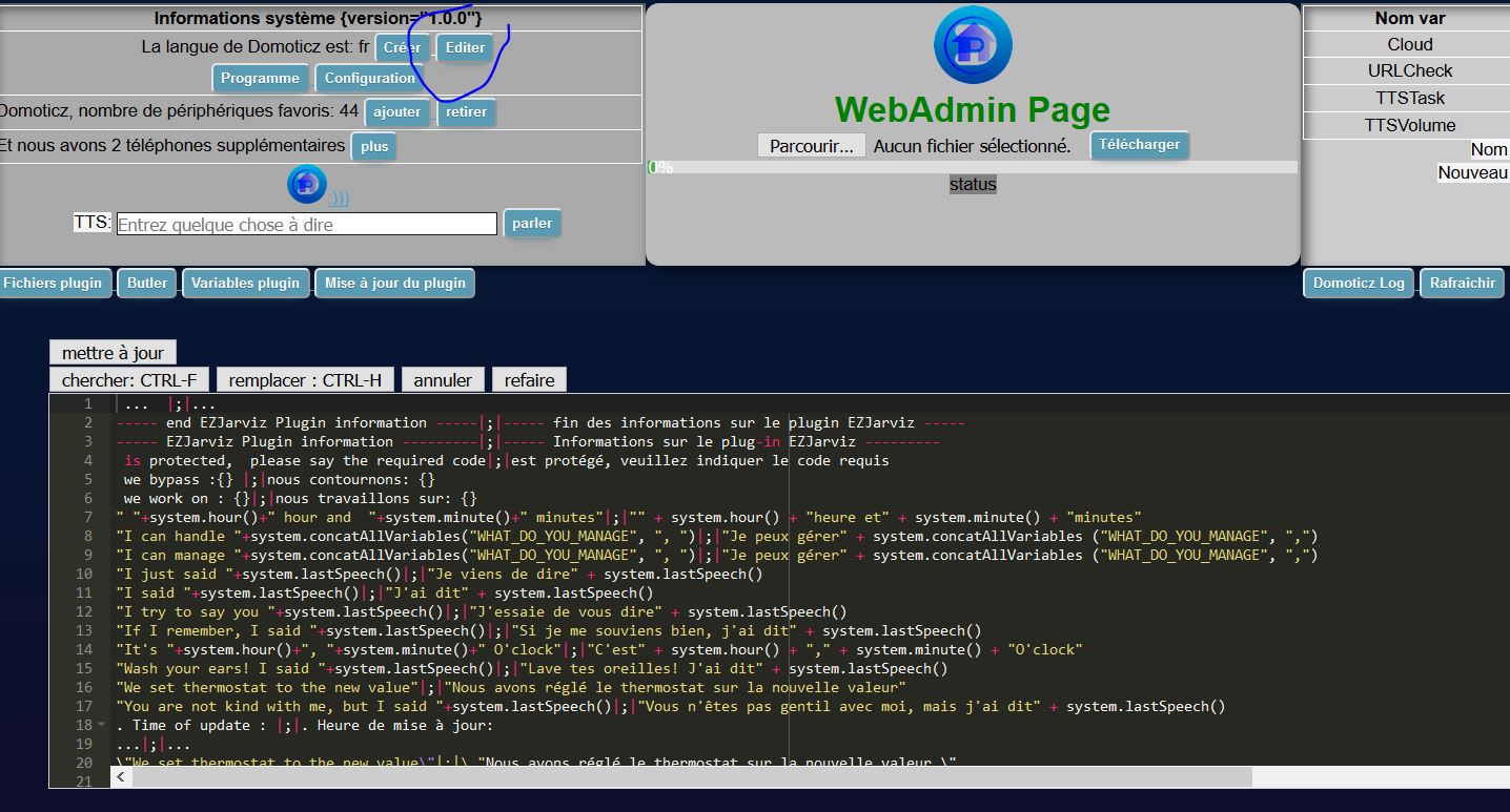

Now with On-Line Editor for language file :
