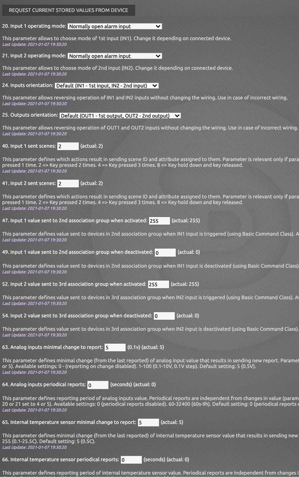

Hi picked up the motivation to get my smart implant to get working in domoticz.
my findings until now is that switching monostable works. input switches output directly.
but i want that info to trigger a scene/switch... but in domoticz the smart implant switch delays for a minute or so..

Also when I shortcut the input wires the output is not triggered? Why not? I like this behavior but it is not according to the spec.
I want to trigger a doorbel, so when the input is triggered the doorbel needs to switch on. I can control the output from a script but then I still need a trigger from the input. How can i achieve this?
I’m running Open Zwave Version: 1.6-1033-g3661f170.
These are the options/switches in Domoticz for the Smart Implant:
rgroothuis
- Posts: 347
- Joined: Friday 03 April 2015 17:09
Re: Fibaro FGBS222 Smart Implant
I was able to finally get this working. The input 1 and 2 are set to "Normally Open alarm input". With this configuration I was able to catch the user trigger on the input into the dzvents script. From the script I was able to control the output, either 1 or 2 (Deurbel 1 or Deurbel 2 in the above picture). So i can decide if I use input 1 or 2, one of the input directly controls the doorbell while the other I need to trigger the bell from the script. The second one is what I prefer as I then can disable the bell for example at night. So it looks like I've a working solution now.

Below the overview of how I've configured the smart implant.
The simplified script I'm using is:
