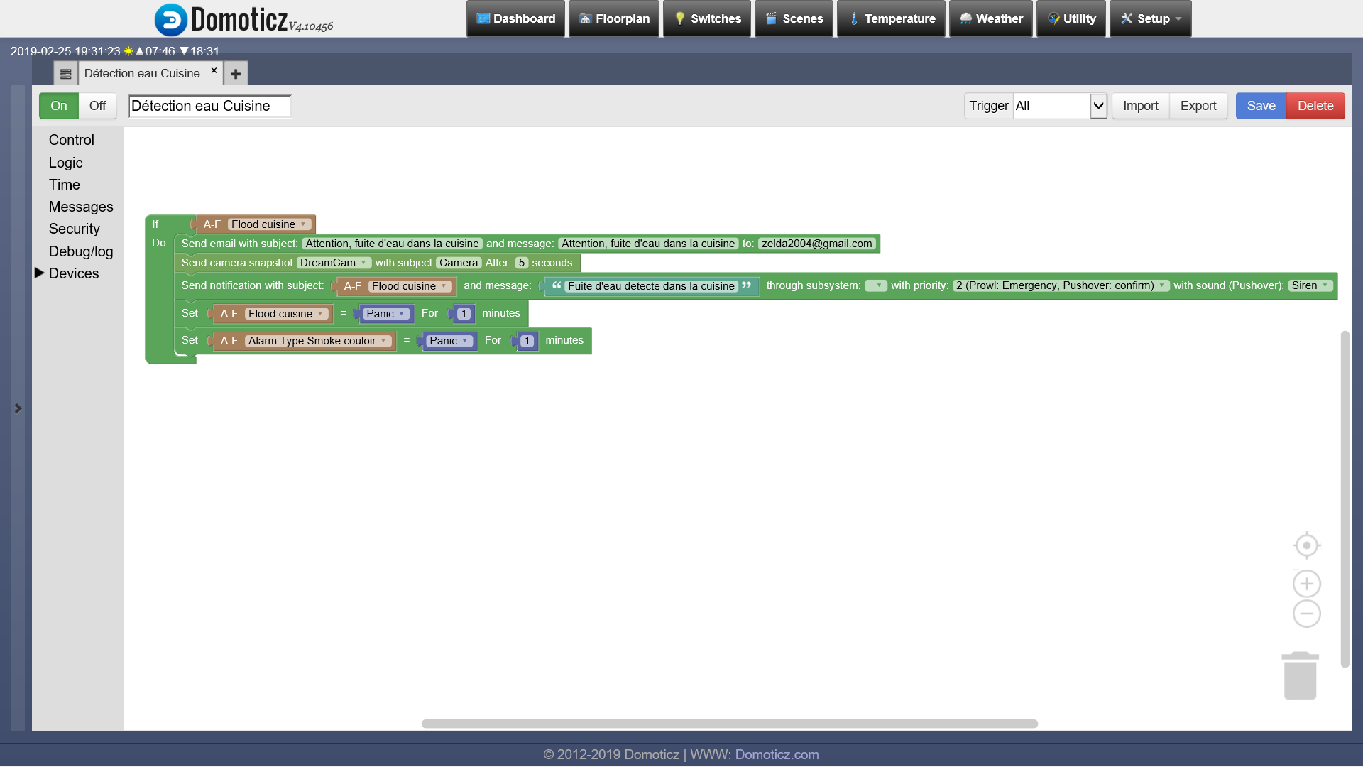

I Would like to know how to set a script for this kind of use :
- When Flood is detected : active smoke sirene (Fibaro) for 0.5min then send me an email with picture cam and send a push notification on android appz.
I try it with block, but doesn't work :(
I really appreciate your help
thank you
screen
screen
block flood.png (110.87 KiB) Viewed 1424 times

Hi, it appears your "if" statement is not complete.
If flood = ?????

It is also not possible to turn on the fibaro smoke sensor siren remotely.

Ok for remotly sound.
For the block, wich one i have to use ?
