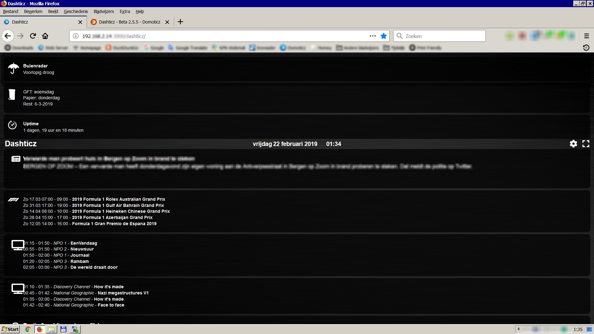

Just installed version 2.5.5 Beta and something strange happens. The screen is totally mixed up. If I click somewhere on this page all my buttons are loaded in separate tabs. Is it just me having this problem?
Blah blah blah
Lokonli
Posts: 2292
Re: Dashticz - Beta 2.5.5
Post by Lokonli »
I've tested on Firefox (Linux), Chrome (Windows), Fully Kiosk (Android), Safari (iPad): no issues.
Maybe some interaction with your cache? or your custom.css?

I had a same kind of problem, adding the lines below from the custum.js to my own custom.js solved the problem in my case.
function getExtendedBlockTypes(blocktypes){
//blocktypes.Type['Lighting 2'] = { icon: 'fa fa-lightbulb-o', title: '<Name>', value: 'ds' }
return blocktypes;
HansieNL
Posts: 969
Post by HansieNL »
@rleunk Thanks, that solved the problem :D
