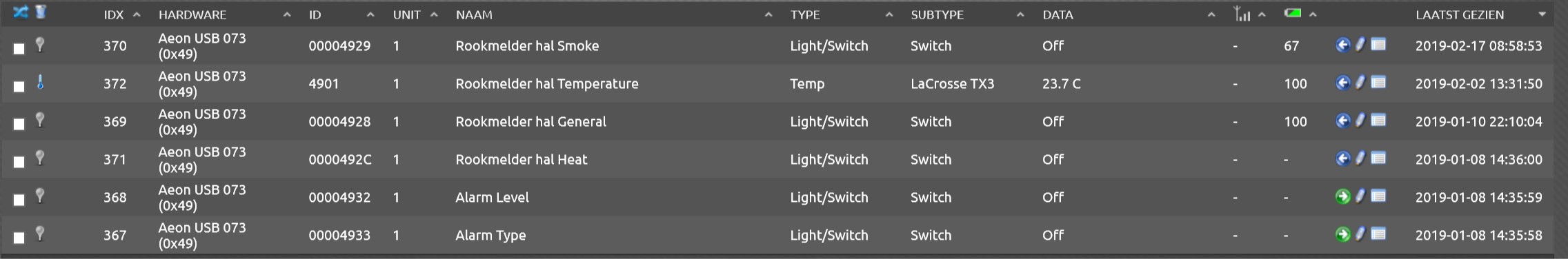

I have some Fibaro smoke detectors and sometimes some of them display some weird behaviour:
Smoke detector.jpg (110.67 KiB) Viewed 305 times
What I think is weird here is: the device is connected directly to the Z-Wave controller (my Domoticz machine), but it shows the last temperature report was on 2019-02-02. I have set the temperature report interval to 720.
I could understand the "Smoke" or "Heat" switches to have a last seen date that is old, but I would expect the "General" and "Temperature" to be more recent. The self test of the device shows it is not malfunctioning.
Can I fix this other than removing the device from Domoticz and adding it again?
