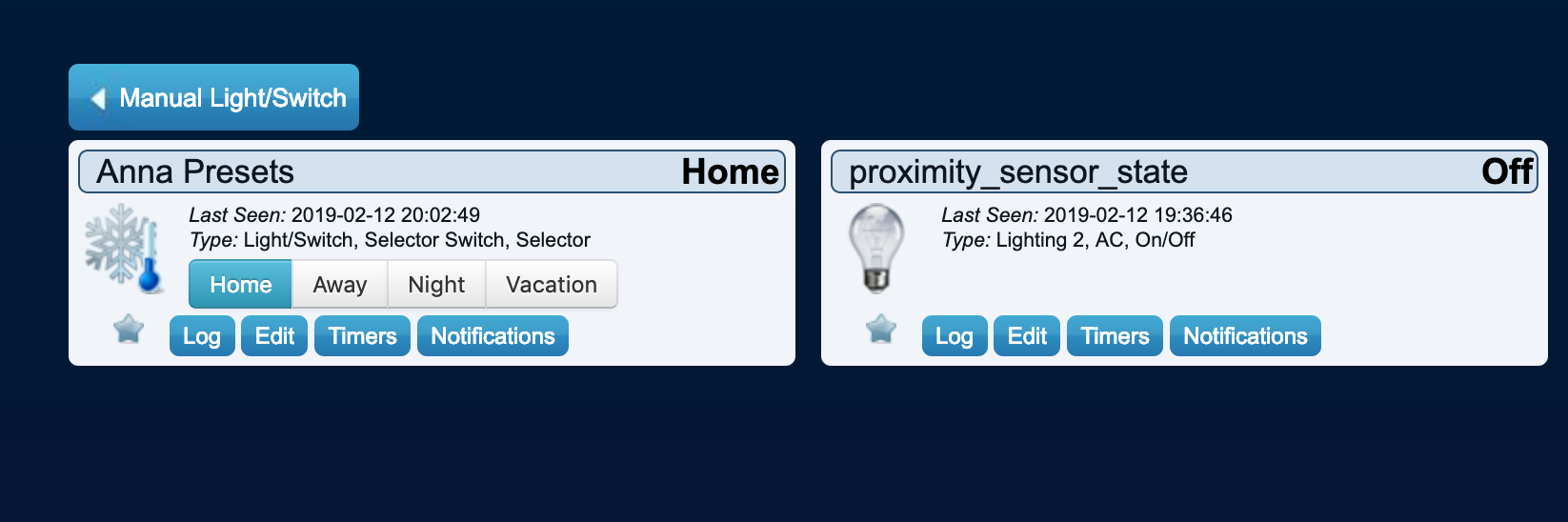

Hi there.
I've got a build ready for the Anna thermostat that should hit the latest beta build hopefully by the end of the week
This release is meant for broader testing of the functionality
It will add support for the build in scenes from the plugwise gateway and enabling/disabling the proximity switch from Domoticz
You will have two extra switches in Domoticz Anna Presets & Proximity_sensor_state
Both switches will update the Plugwise Gateway used by the Anna
You can detect when a preset/scene is changed and act on it. and you can set the preset/scene though events Known limitations:
THIS IS BETA it may fail as I can only test against a Anna with firmware 3.1.4. Please let me know if it works with older firmware.
I may change the way the presets as I optimize the code in the near future but for now
setting a preset is done by using a number in the following way:
Setting the levels as level (see above):
Home = level 10%
Away = level 20%
Night = level 30%
Vacation = level 40%
No support for frost level. the plugin will show the switch as off if the gateway is set to frost ( from app or on the Anna)
for now language is hardcoded to english
I'll update this post when it has hit the Beta

I tested it on latest beta today and on Anna thermostat with firmware 3.1.4.
when i tested it, i can push the buttons and log displays:
2019-03-12 20:48:47.969 Status: User: Admin initiated a switch command (55/Anna Presets/Set Level)
but when i use webbrowser to browse to Anna, then nothing is changed there
edit: after some minutes, Anna presets in domoticz changes back to current preset
btw. changing temperature setpoint in domotics, changes the temperature in anna

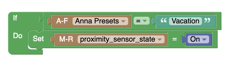

Also when I change the preset on the Anna itself, in the Domoticz Dashboard I see the status changing. But in the log, it's not changing.
So when I want to use something like: IF Preset is Vacation, do ...
It's not working, hope someone has a solution.

Same hereefarmer1 wrote: Wednesday 18 December 2019 19:51 Anny news on this preset function with anna firmware 3.1.10
on my setup domoticz latest stable anna does not respond to preset changes

Hy Eddy, for presets you need a new firmware, if you load Anna in Domoticz it will see the senes switch.
BUT sins the latest update 3.1.1.0 this does not function (for me) any more.
so i created a blockly doing what the senes wold otherwise do.
