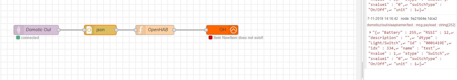

i am trying your example but can not get it to work
have domoticz working
made a virtual switch called test
have openhab working
made an item switchlight called test
imported your flow
changed the payload name to [test]
when i flip the test switch in domoticz i do not see it flip in openhab

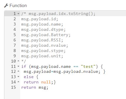

i suspect i need to do something more but am not familiar with nodered
this is in the OpenHab function
i also have MQTT working(from domoticz-to openhab) but the whole idea is that i use nodered instead so i can use it bidirectional
