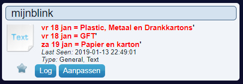

nope, now I get
<font color="red">vr 18 jan = Plastic, Metaal en Drankkartons</font>' <font color="red">vr 18 jan = GFT</font>'Your mind is like a parachute,

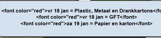

Hoi Jos,
I now get in the TAB others the right format. but I also placed the textbox on my floorplan.
here I get So the alignment is crap and the color is not coming over.
JuanUil
- Posts: 500
- Joined: Friday 22 May 2015 12:21
- Domoticz version: 4.11083
- Location: Asten NB Nederland
Re: alignment of text in a dummy text device
no Idea why the textbox on the floorplan is different then in devices
- jvdz
- Posts: 2485
- Domoticz version: 4.107
I don't know either, I am not using àny floor plans, but guess the text isn't treated as regular HTML in the floorplan, unlike the Text sensor text display.
Maybe somebody knows.
JOs
