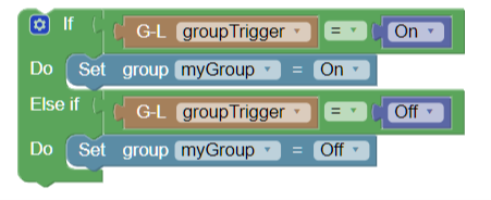

I have a zwave mesh and a 2 gang switch near my front door.
I only used 1 gang wired and the point was to use the second gang as a virtual switch to turn off all lights when i'm leave.
I already made a blocky but this is not working.
I create a group and this works but i cannot connect the group to the switch?
Can anyone point me to the right direction how i can use a wall switch to controll other switches?
greets G,
greets G,

There are more answers to this.Gianni wrote: Saturday 29 December 2018 0:38 Can anyone point me to the right direction how i can use a wall switch to controll other switches?
1. Group activation device; goto the edit page of your group to the part Activation devices. Press Add device button and you will have a couple of seconds to press the switch that you want to control your group.
2. Use dzVents script below.
3. Blockly
- Spoiler: show
- waaren
- Posts: 6028
Re: turn off all lights
It is either 1, -2 or 3. So one of them is enoughBladeM3 wrote: Saturday 22 February 2020 8:40 Do you have to use both Blockly and dzVents to make this function work? Or only one of them is enough?
