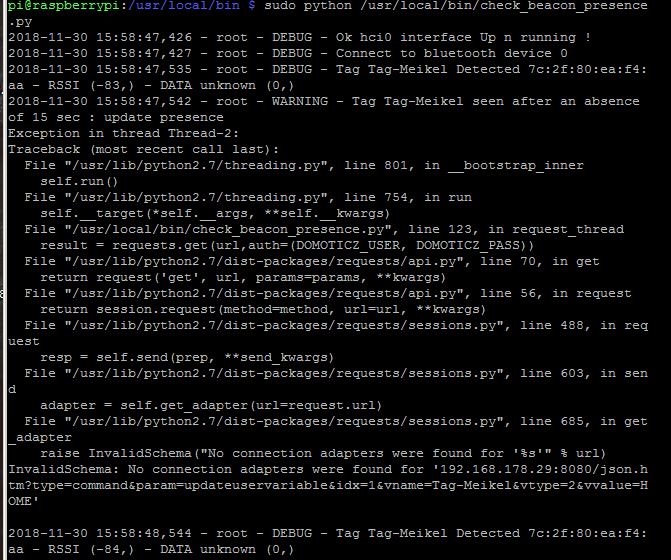

got the bluetooth beacon presence detection running with no success. System is a Pi3b with debian stretch and Domoticz 4.9700, beacon is a G-Tag which I can see with the lescan tool. Uservariable is set but no change from "away" to "home".
Errormeldung 02.JPG (110.29 KiB) Viewed 204 times
Can somebody translate for me the output when I ran the script manually?
Thanks in advance.
