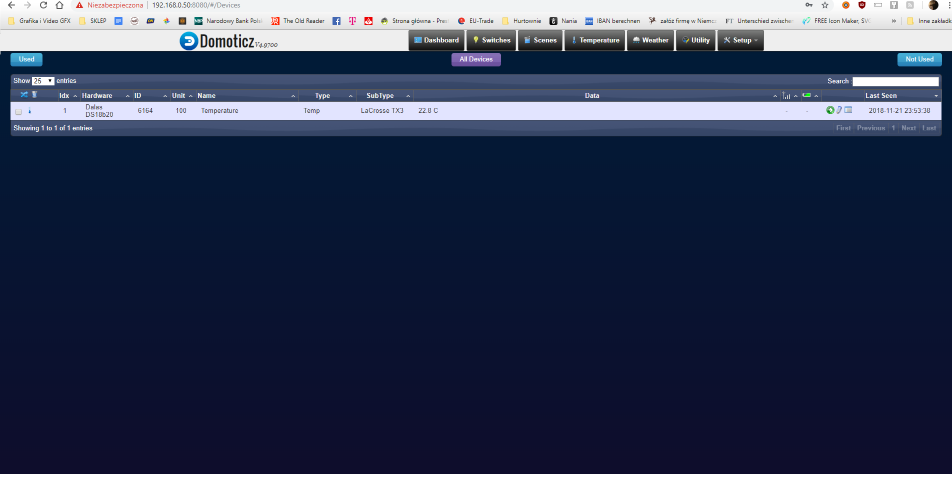

I'm new in Domoticz but make all like in Tutorials in web with the dallas Ds18b20 sensors and in Commandline the sensors work great i see 3 sensors, can read temp but in domoticz after adding 1-wire Hardware comes just one Device with Temp and the temp shows in time form one sensor 21'C ontime from the other 43'C.
Have checked the stable version and the Beta and the worst thing have make a new Raspberry instalation al time the same issue just one Temperature Device :/

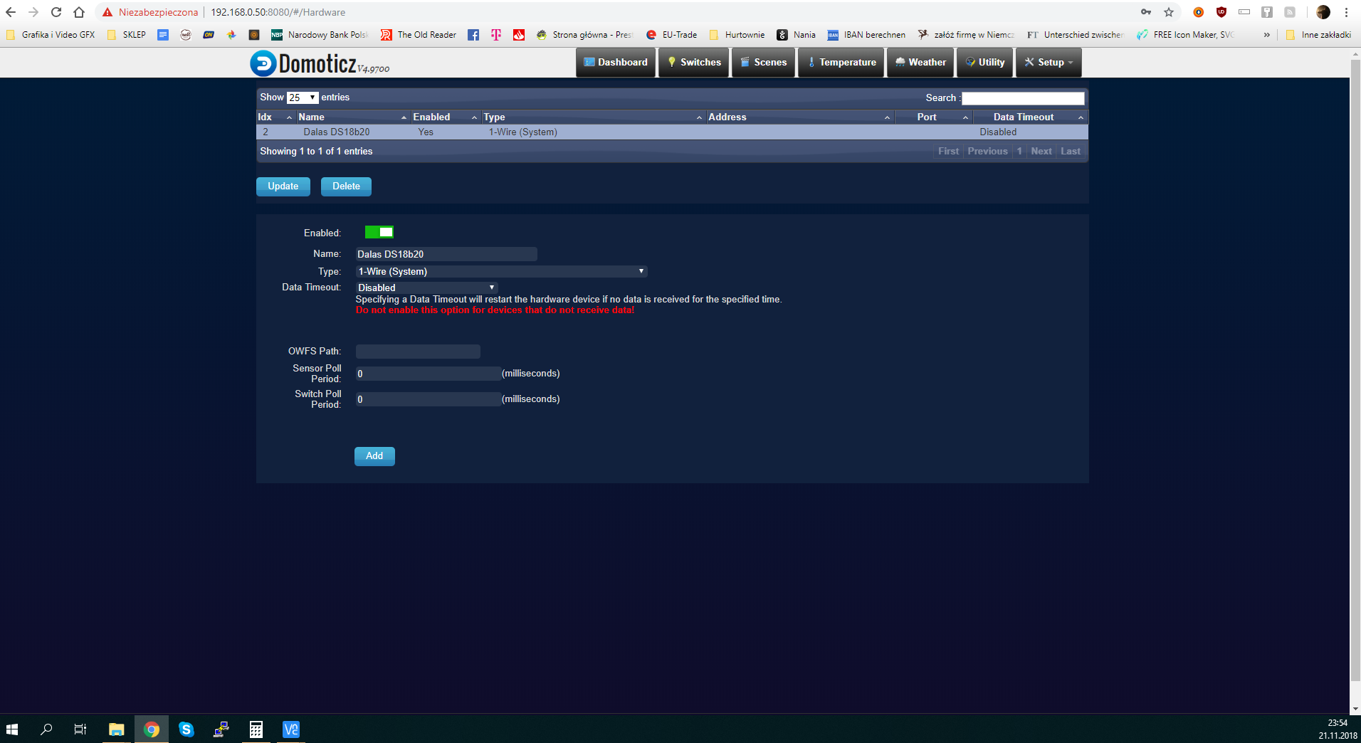

Have checked 4k7 resistor , 2k2, 10k al the same issue nothing helps :/
OWFS Path: not filed
Sensor Poll Period: 0
Switch Poll Period:0
in Log seams to the 3 devices wehre added but nothing appears.
What make i bad? all seams to by ok but nothing helps :/

I have the the same problem, all my sensors appears in the domoticz log as added device, but in devices they all is in the same line,
Everything worked at my last installation before i have to switch memory.

I just noticed that in your Domoticz 1-Wire hardware setup you reset both Poll Periods to 0, why?
You should keep the defaults:
Sensor Poll Period: 300000
Switch Poll Period: 100
if you want to pool sensors (temp reading) every 300 sec or change it to some other value (it is in miliseconds).

In the screenshot from your 1st post I can see that you are running very old Domoticz v4.9700 and your settings for 1-Wire hardware have wrong Poll period values.
Did you install latest Domoticz stable 2022.2 and configure 1-Wire settings as i suggested?
