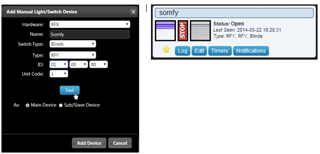

Great news about controlling Somfy motors,
We got lots of qeustions for supporting somfy, and now we got an great answer!
The RFXtrx433E become available from June 2 2014.
RFXtrx433E is A succesor of the great RFXtrx433 with the possibility to control Somfy motors.
We already got an prototype from rfxcom.com to implement and test.
And the Domoticz team has build in support (from beta 1772)
I have tested it and it works great!!
You are able to add a manual switch,
Give it a name, Choose type RFY (the name of Somfy in Domoticz)
Set a random unique Id and Unit,
Click test to pair and Add device.

- Somfy Magic
- Somfy.png (49.81 KiB) Viewed 40333 times
